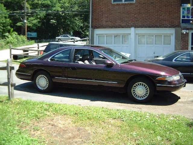

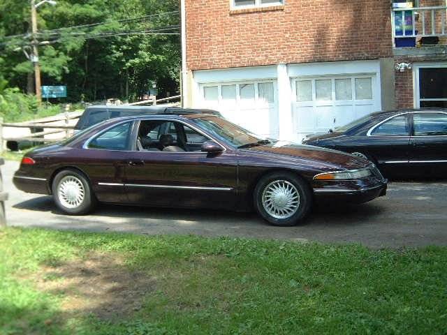

Here is a pic of my friends 94 that I sensor lowered the way with the slot. BTW I can lower it much more by sliding the bracket more. There is alot of adjustment there. A stock mark sits extremely high in the front!
when I lowered my friends 96 I didn't have to move the sensors as much as in my 97 not shure why

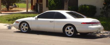

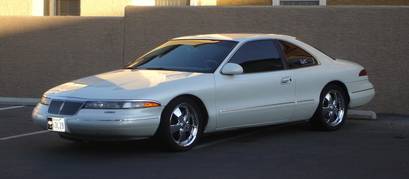

Ok, let me end ALL this discussion......I live in Pittsburgh, and I have EVERY sensor on my car adjusted to the ultimate limit AND I run a smaller diameter tire than factory and I have NEVER bottomed out anywhere....>AND I have driven at over 130 MPH on every highway around here. Not only that, but I have driven around here with the suspension slammed (via my switch) and have not bottomed out either. Now, with that being said, I have driven a lowered vehicle for almost my entire driving life (second car I heated up the springs and slammed it......got my license at 16 and I am 38 now). You will NOT hit anything simply by lowering the car with the sensors no matter how low you go. My car is roughly 3 to 4 inches lower than stock without me hitting my switch and releasing the air out of the suspension.
Sensor lowered with 245/50 16's:
Lowered Via my switch:
First pic is of the car factory height with factory sized wheels/tires, and the second pic is the car after the sensor lowering with factory sized wheels/tires:
