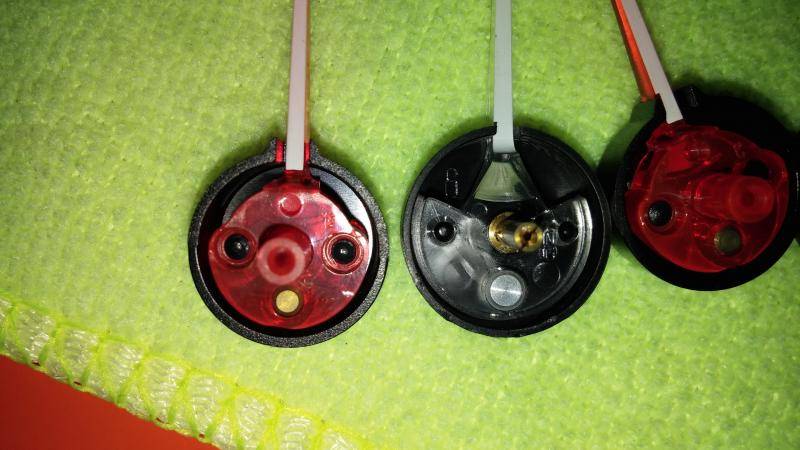

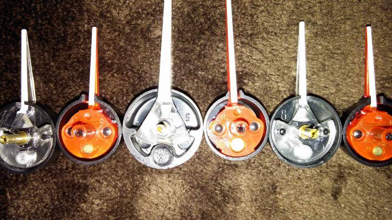

Alright so I was told the 2000 Ford Taurus needles were cross compatible with the Mark VIII. I ran across one in the JY with needles in excellent condition so I grabbed them. Tore into my cluster today and went to replace mine. Only the speedometer needles match, the others have a "hole" on the back matching the size of only the speedometer while the Mark VIII has a bit smaller brass type hole on all the other needles.
Does anyone know if there are any other needles that are compatible or if it is just specific 2000 Taurus' that matched up? Or any other information in general on it. Like perhaps using something else inside the larger hole to reduce the size so it matches up.

EDIT- Actually, my smallest bit was 1/16th and that doesn't even close to fit. I took an old school push pin and a sewing needle and neither fit in the hole of the Mark VIII needle. The tip of the sewing needle goes in, but doesn't go any further then that.
I wouldn't know what I could use to create a hole that small.

So, I took some bumper/flexible epoxy and I filled the hole with it. Let it sit for a good 5 minutes until it started hardening then I stuck them into the extra cluster I had up here to create the center holes. Let them dry a few more minutes then did it again to make sure it was a clean hole. Hopefully once they harden fully, they'll stay snug like they felt when I tested it and all will be well.
If not, I'll go grab some more from the JY and try again. I figured the bumper epoxy would work best because it's almost like clay when it first starts to harden as apposed to plastic weld epoxy that stays pretty tacky up until it completely hardens.
