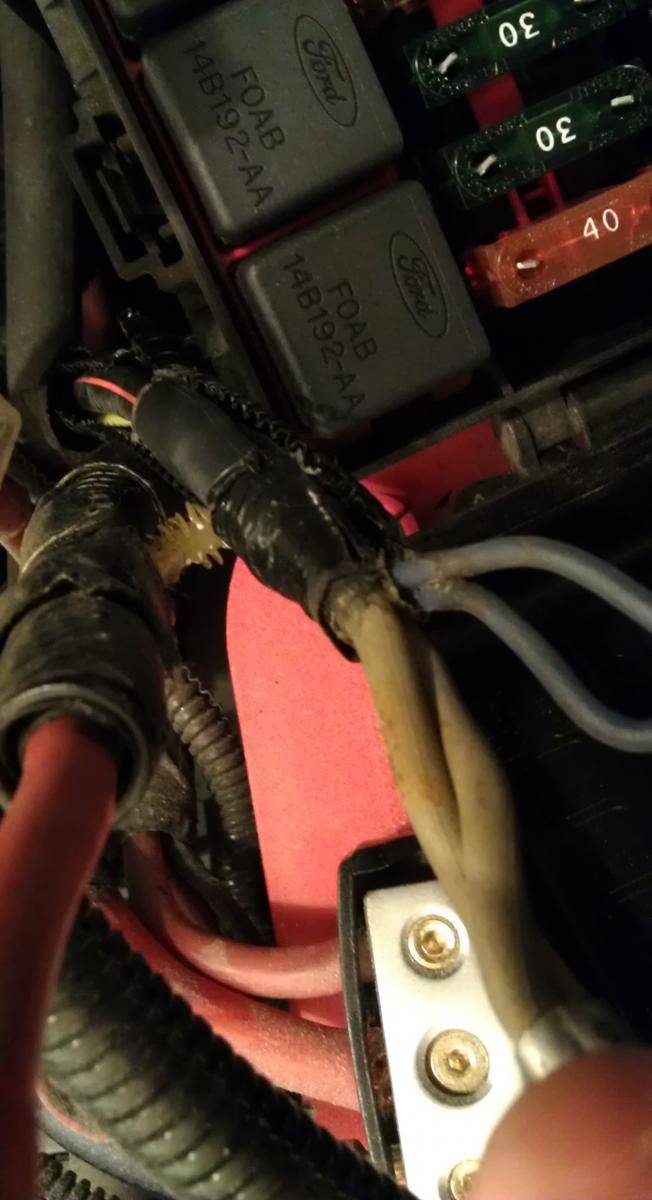

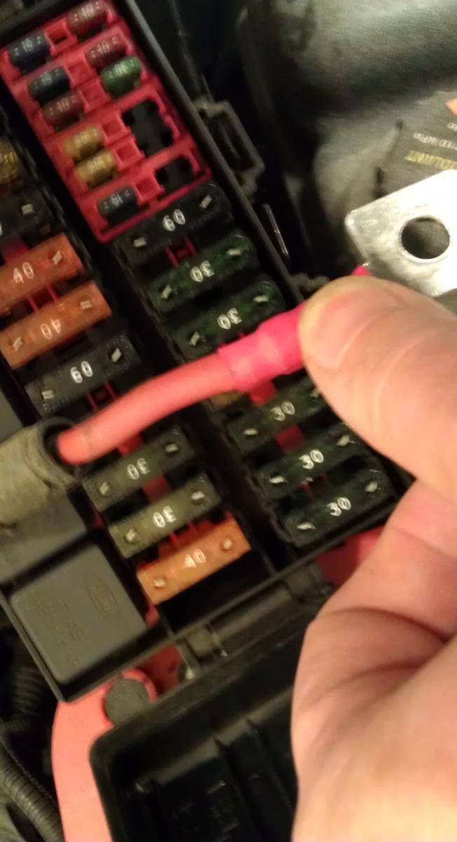

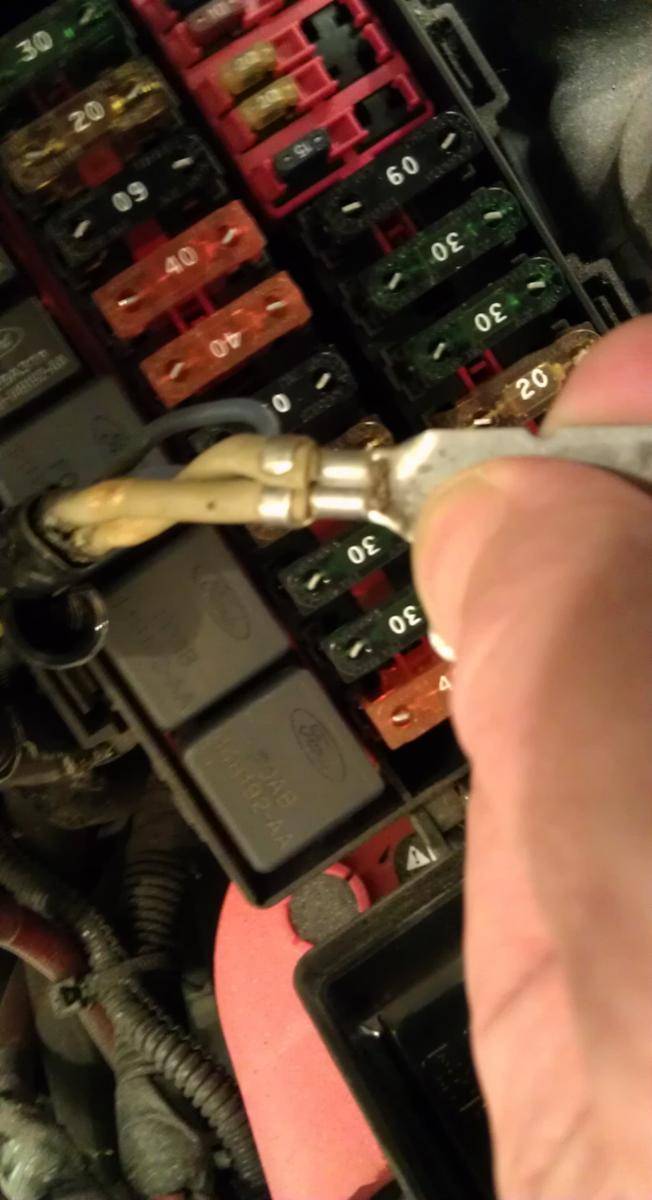

The wire that runs from the factory alt and I forget the rating.. 120/130 amp is at best 6ga which goes to a 12ga fusible link and has at best 2 12ga fusible link wires coming out of it; with a loop to the alt sense wire. This thing is on the stud of the under hood fuse box which has the wire to the battery (even smaller) boarder line 8ga.
I won't hardly run 8ga for a big amp, certainly nothing I'm going to put a 60 amp fuse in (which is the largest in our box) not to mention the rest of them.
I know the amp rating says it ok but when it comes to power I lean to the overkill side of things.

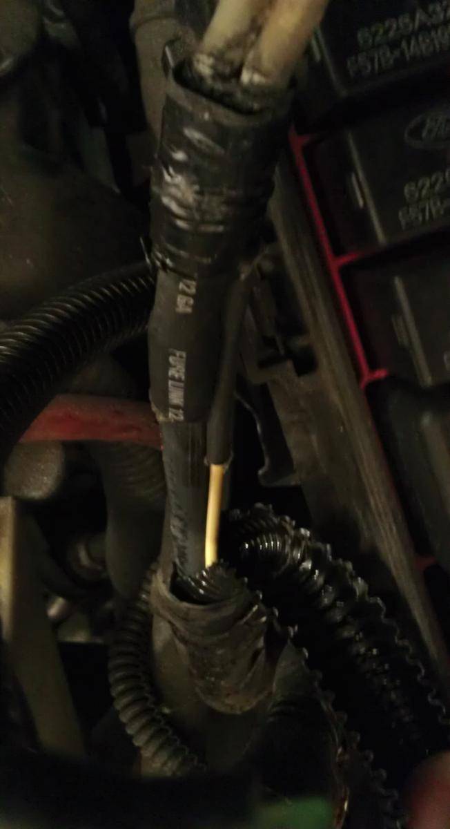

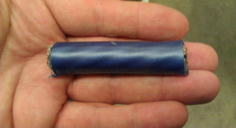

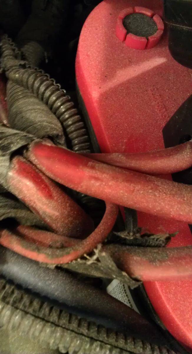

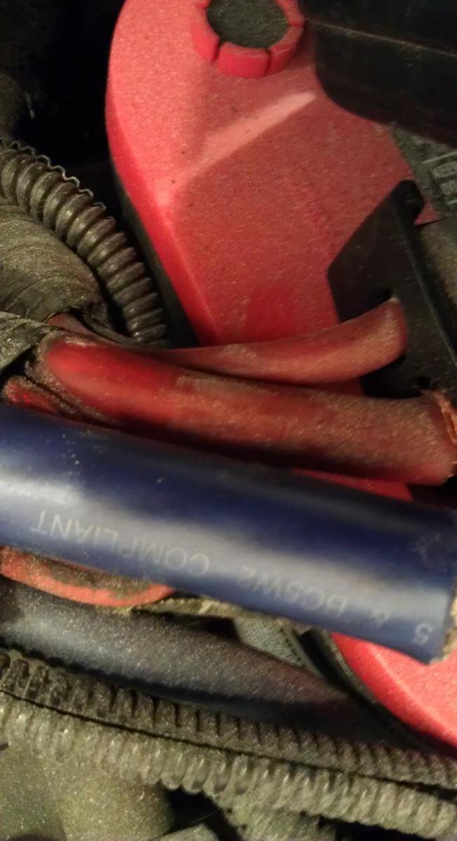

In the pictures you will see the fusible links and where they got hot at one point, the factory alt wire, the factory power wire for the fuse box. From right to left on the battery terminal you'll see the factory power wire to the fuse panel, the 4ga I put in to the alt, and the factory starter wire. You can see the size difference and you will see what 1/0 looks like in comparison.

60 is the largest fuse in the box under the hood but I can't see it being less than what the alt was rated for. Could be wrong though.
The Mark VIII electrical troubleshooting manual confirms your description about the fusible links. There are two 12ga ( Gray wire) leading into the fuse box and one 20ga (Blue wire spliced onto a Yellow wire) leading back to the alternator.
Unfortunately, the troubleshooting manuals does not identify fuse link current rating.
The David Navonne adopted competition wire appendix (used in the major soundoff sanctioning bodies) states that a 20ga wire that is 4 feet or less can handle as much as 10 ampere safely and a 12ga wire that is 4 feet or less can safely handle between 26 amp to 50 ampere of current. I would consider the vehicles fuse link current rating to be on the lower end of the scale since high engine compartment temperature would contribute to the fusible wire link internal temp melting capacity. So it is safe to assume that each of the 12ga fuse wire will handle 30amp each based on the largest fuse in the fuse box. If the wire jacket appears blistered, the link may have gotten too hot and may be compromised.
Before you do the pull test, have a replacement fuse link wire handy if not, then a couple of spliced 30 amp slo-blow fuse may take its place.
Check the link condition by pulling it apart between its end and the splice. If you feel the wire come apart, then you'll know that the wire inside was bad. Its time to replace.

hey 97 the fuseiable link the yello/ blue wires that ur holding in the top picture is what i was talking about
The fusible link are the white wires. The yellow wire is the alt sense wire. The blue loop is just how the connected it.
what did you run that big blue wire to .
I'm assuming thats the wire he used for his " big 3".

I must say that the big 3 helped me greatly this winter. Quite a difference compared to years past. Maintaining 14v+, little to no dimming and cured a hvac issue I had when it was below 30 degrees.
For anyone that would like to utilize the stock system to its fullest potential I highly recommend this.
