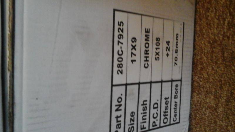

posting my deal I just got and fit question same time!!!
rcab85
Aug 10, 2015
25
Milltown
Went on ebay found 17x9 cobra r rims made offer at 450 shipped bam I hope they fit since there is no sticky on wheel fitment 20150810_184607.jpg
thats point 4 (0.4) mm. which is very little.
the alternative would be to keep searching, or to have some custom rings made.
but these will be pretty close, and are cheap.
says different rims need different thickness rings?
This is correct, plenty of wheel manufacturers use a different ID for hub width. I had to use a micrometer to spec my wheels out, and then find a set of rings that would fit them to my hubs by measurement. I think they were 63.4mm to 72.5mm or some such like that. It's a pretty simple business, though.
I understand that but they say the actual width of the ring oh it just hit me, take a wheel of and mic the ring on the hub?
