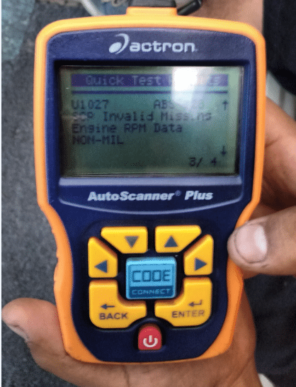

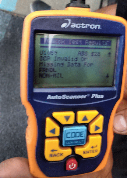

went to my local parts store and scanned for these DTCs
I'm starting to think I could have a bad PCM...?
