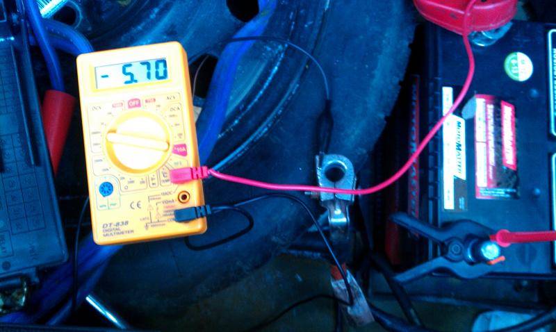

so today it was a bit less cold so I pulled out my ammeter and measured a draw of 4-5amp, pulled out every fricking fuses and relays (under hood, under passenger side and trunk) but I still have a constant draw...

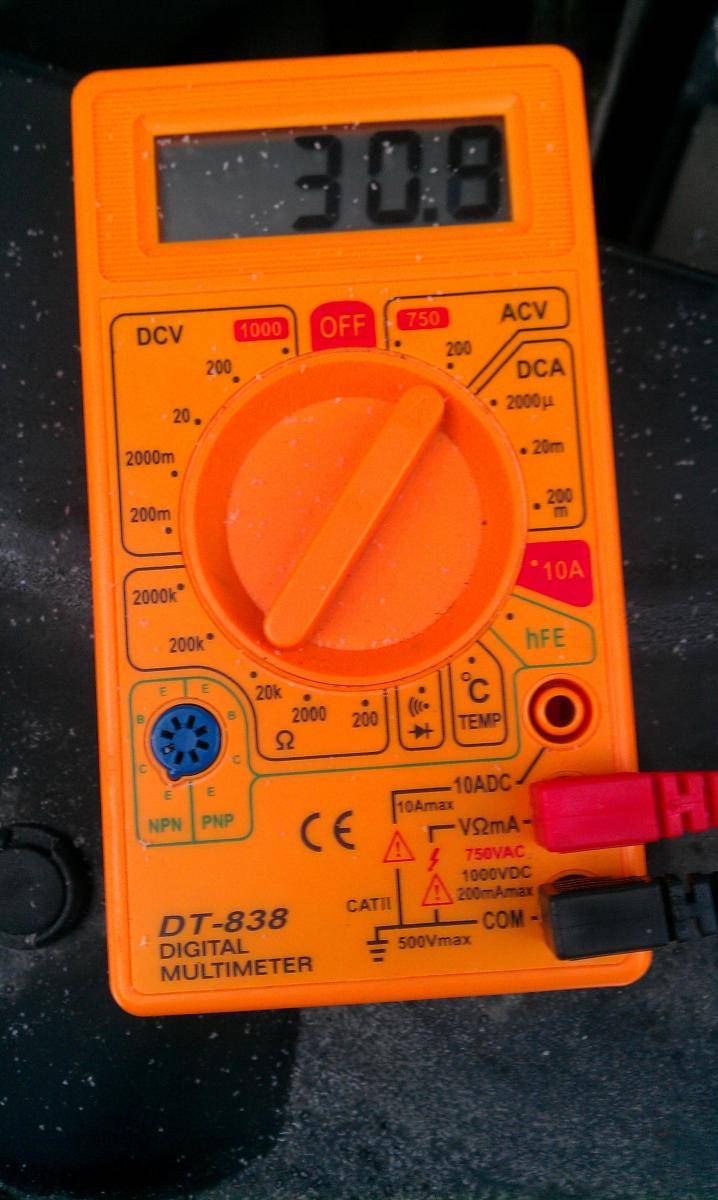

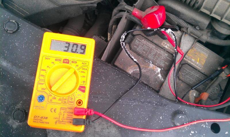

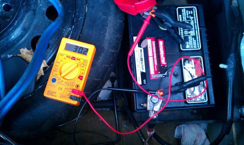

alright so i plugged the voltmeter and got a reading of 30vac?
i attached some pics just to be sure i did it correctly :p

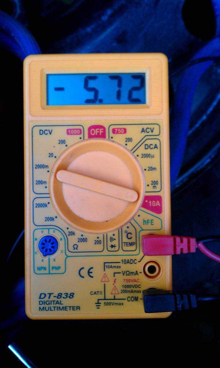

also uploaded pics of the reading of the drain (5.7amp)
so what do you say joe? bad alt?

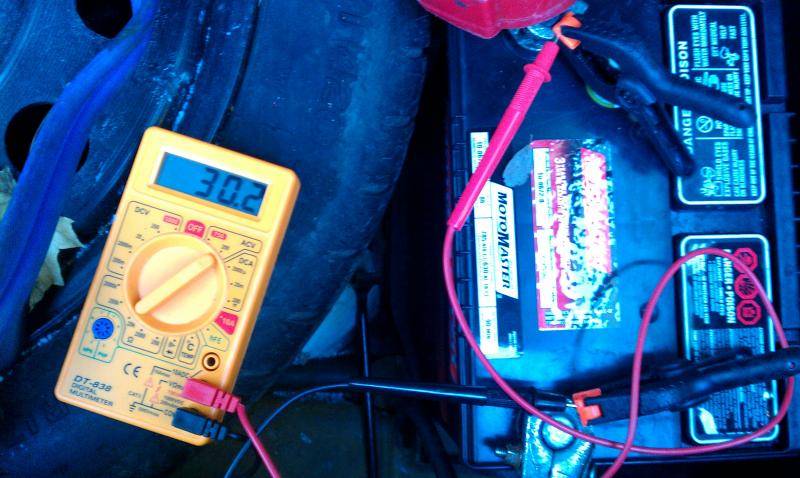

i tested the voltmeter on my mdx and also getting the same reading? :confused:
am I doing something wrong or could my meter be busted?
attached pics of the reading on the mdx
can someone confirm if my settings are right lol
Yeah, but the alternator makes AC, hence the name Alternator. Diodes block one direction of the alternating current flow thus making direct current. Bad diodes can cause AC voltage generation, or battery discharge. I dont know why his MDX is outting out 30 VAC.
It's possible that your meter is too cheap to correctly measure AC voltage in the presence of a DC voltage.
The regulator uses several diodes in order to rectify the voltage down. Perhaps only one diode is fried? I could see a single bad diode allowing part of the AC to bleed through, and it would only take one bad diode to backfeed the battery through the alternator to ground. Now this is assuming that the engine is running while this reading is being taken. If the engine is off I would say the meter is not reading correctly.
One thing I'm confused about, what kind of car is this? Thought all LSs had the battery in the trunk?
Whoops, didn't realize WTH was going on. I never thought of trying that to detect a bad diode - brilliant! At least if the meter is good enough.

did some further research and i've concluded that it must be indeed my meter;
this guy was having the same readings:
http://www.garagejournal.com/forum/archive/index.php/t-75551.html
and as per this post:
"At one time it was extremely common for AC meter ranges on analog meters to read about double the correct value when DC was applied.
What you are seeing is almost certainly somebody using the old style circuit. "
http://electronics.stackexchange.co...eter-readings-measuring-12v-lead-acid-battery
so it would make sense that i was getting 30vac on both car batteries, i tested some regular 1.5 AA batteries and also getting some 2.x vac on them.
I will head to the store later to get another meter and report back (mine was real cheap at like 4$, last week i bought 2 cheap meters on ebay as backup but i guess they'll be junk too)
