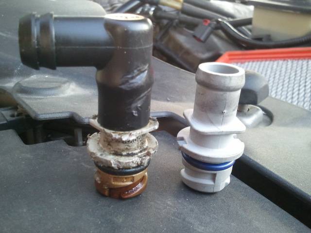

um, so how the hell do i get this plastic elbow off the old PCV valve??? :confused:
i mangled the old valve in the vice. but the gashes on the black plastic elbow were there already and i suspect someone else couldnt figure it out either. even if i get it off i suspect ima have a hell of a a time getting it on the new valve. that plastic elbow is not flexible.
am i just stupid? surely someone else has had this problem.

Supposedly, this truck part will work. YL8Z-6A614-AA Otherwise, you have to buy a kit of the PCV plumbing.
You buy a new elbow that is not heat hardened for the same price as the PVC valve.

http://www.ebay.com/itm/Ford-Crankcase-Vent-Elbow-Part-YL8Z-6767-AA-/260911788529
should be correct.

im not even sure that if i buy that elbow that i can get on the new valve :frown:
Dude,
It had to get on there in the first place. What else are you going to do at this point, put the old one back on?
If the new one is hard to put on put it in a pan of hot water for a few minutes.
good idea. i was gonna try my heat gun but someone borrowed it... like a year ago...
Be warned, the new elbow may not be "heat hardened" but it is still pretty stiff.
I used a large C clamp to push the PCV valve and elbow together. It was the first thing I could think of (that I had laying around) and it worked very well.
I highly doubt the old one will come out.
I went through this last month. Used emory paper to sand down the barb on the PCV valve till it started to fit in hose. Used some glue on the inside of the elbow. I dont think this is a high pressure conection. Good Luck.
