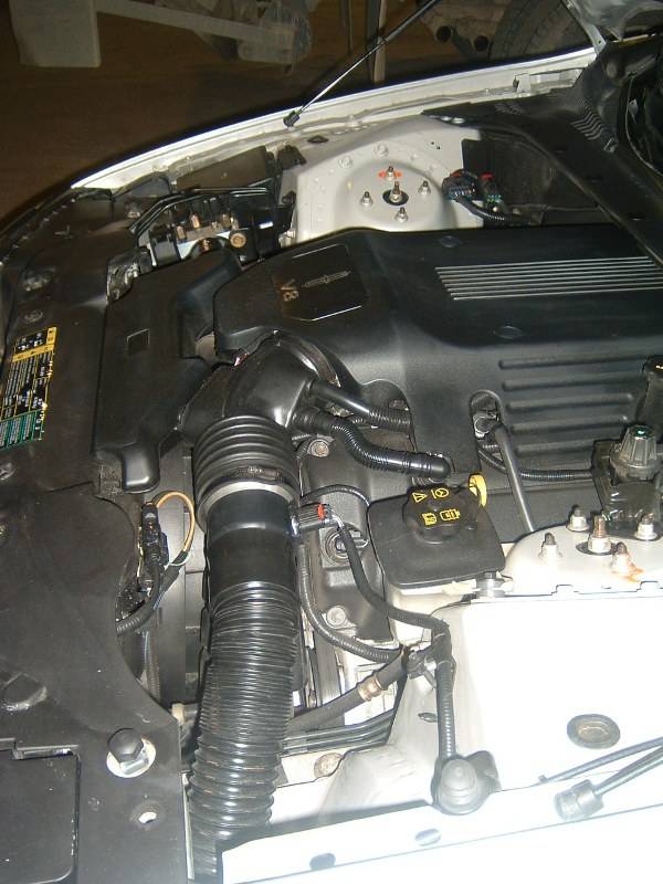

pics from weekend of CAI setup on 03+
02V8Sport
Aug 1, 2005
2,822
6
In Hiding

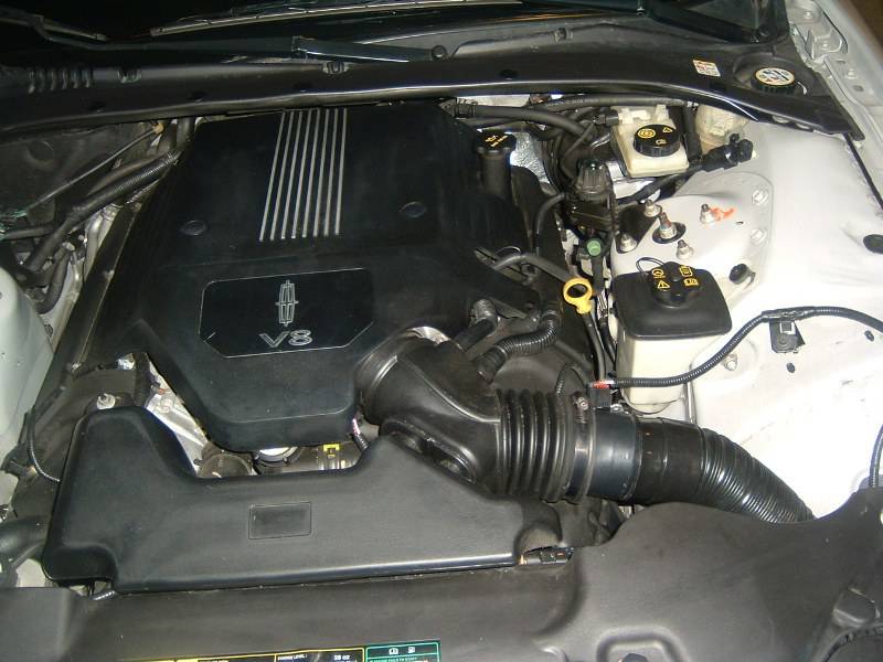

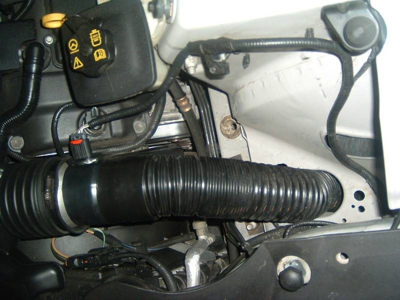

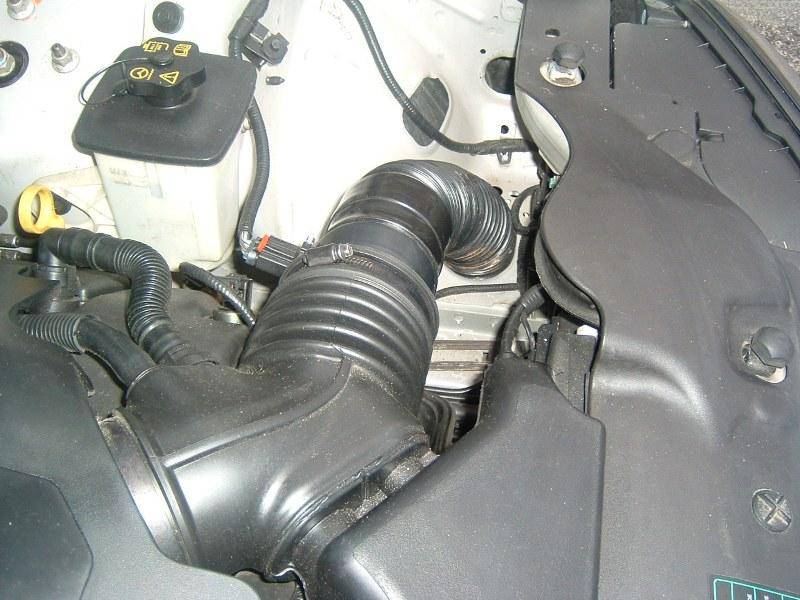

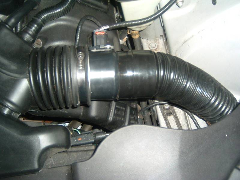

I made a custom adapter out of 3" tubing which I expanded one side of the tube to 3 1/2" with a muffler pipe expander and then expanded further to 3 3/4" at the edge to make it fit into the stock air intake tube coming from the engine. I then milled out a slot in the middle 3 1/2" section for the MAF sensor. Last I just hooked up the 3" intake tubing running up from my front bumper mounted K&N cone filter to the end of the adapter I made. Though some of you would enjoy ideas on how to make a true CAI on the 03+'s
Not bad at all. Any power gain? Are you planning on installing some kind of heat shield as well for the tubing?
Thanks!! The power gain is very noticable. I had this same setup on my 02 but it was much easier to do there since the MAF wasnt integrated into the airbox like the 03+. I ran tests with my SCT software on my laptop and adding a heat shield to the tubing wouldnt justify the work. The air intake temp sensor is seeing the air at the same temperature as the actual outside temperature, with this setup the air doesnt have time to heat up in the short distance it is in the engine compartment. This whole setup I have now cost around $50 of parts and my time. Well worth it.
Not a bad price for a few horsepower. Have you tried running this setup in the summer at all to check if it makes a difference with the heatshield then?
I did on the 02, didnt have the 04 out in the summer yet. On the 02 the air temp sensor was reading 5-10 degrees higher even on a 90+ degree day w/o a heat shield. The stock air box was pulling close to 40 degrees higer on a hot day. Big difference. On a 20 degree day in Chicago, this setup is VERY noticable. Wish the LS could run like that all year long.

I clean and re-oil the filter every month. The spray on oil repels the water from getting in, I never had a problem even in downpours, but then again Im sure the rain storms in Chicago are not as bad as other parts of the country.
My recommendation for people with concerns like this would be to mount the filter in front of the driver wheel, behind the fog light area, there is plenty of room there as well and its much more enclosed from the elements.
