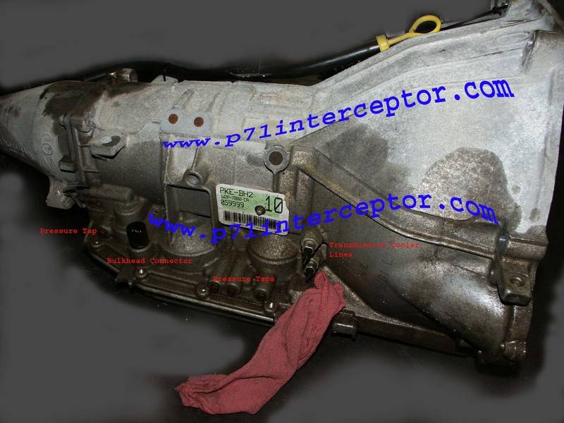

Hopefully the transmission still has the tag on it, for the engineering number:
98 is F8xx-7000
99 is XWxx-7000
2000 is YWxx-7000
2001 is 1Wxx-7000
2002 is 2Wxx-7000
ETC
An example of Crown Vic engineering and model numbers: http://www.idmsvcs.com/2vmod/tranny/modelnumbers/crownvic/index.html
