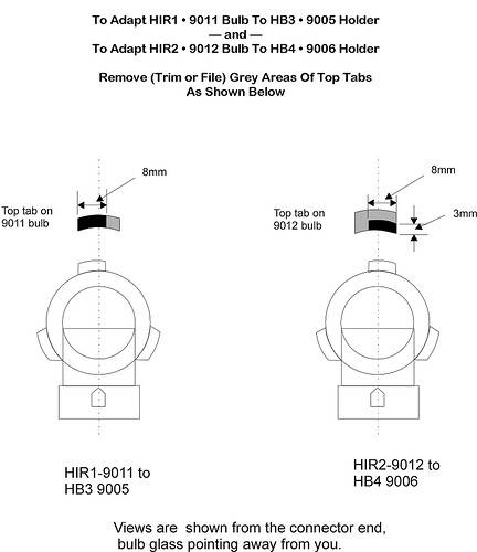

I've thought about getting some for my high beams. I believe you have to modify them to fit. It involves cutting out a divider in the bulb base. Not sure if that applies to the LS though.
Procedure to modify Low Beam HIR2/9012 bulbs to fit HB4/9006 socket (simple):
http://store.candlepower.com/mohirbuba.html
http://pontiacbonnevilleclub.com/forum/viewtopic.php?f=14&t=10781&start=0

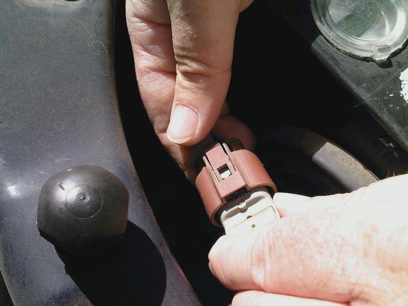

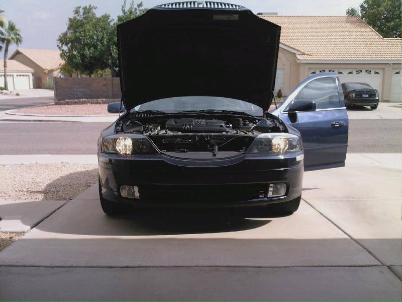

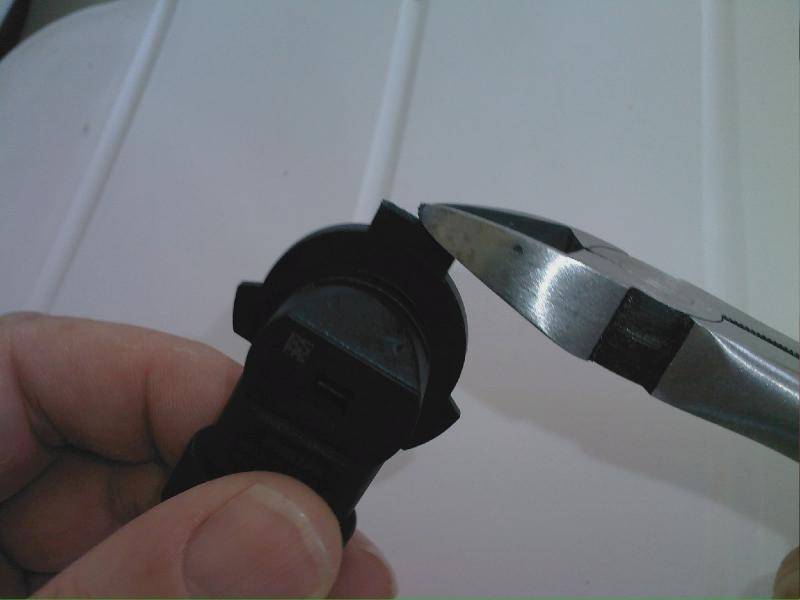

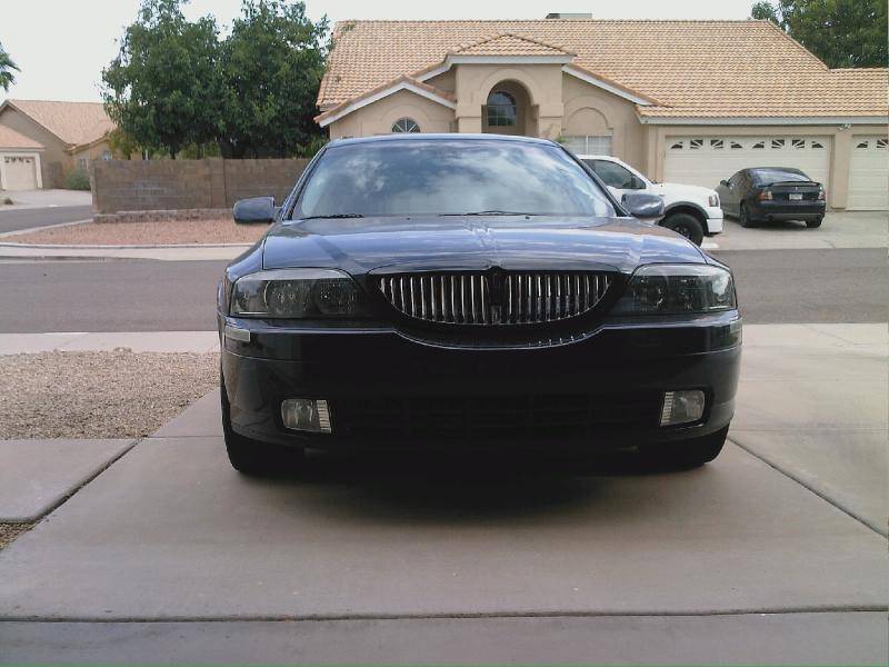

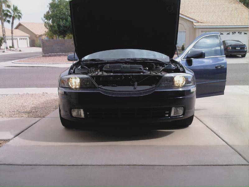

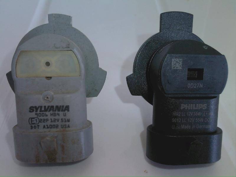

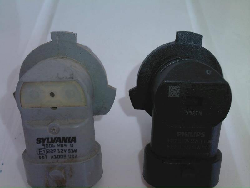

The Philips HIR2/9012 bulbs are here. I had my dremel out, but decided it was easier to just use a wire cutter, and then a slight trim with an exacto knife.

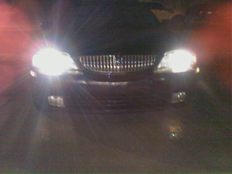

First picture with lights on has the new light in the drivers side, original bulb in passenger side.
Second picture with lights on has new bulbs in both sides.
The new bulbs are whiter... (it's hard to tell in these pictures during the day)

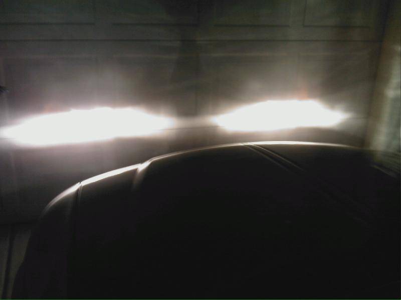

I'll take some pictures tonight with the lights on against the garage door, from where it's parked now at 3'-4' away.
Drivers side Original 9006 HB4 Sylvania bulb (Made in the USA)
Passengers side 9012 HIR2 Philips bulb (Made in Germany)
Nice results. How much better do they perform in Person?
Although I haven't driven it yet at night, it's noticeable in person.
I am going out for a test drive at night in a couple hours... I'll report back on how it works out. My drive back into town is very dark, so I am used to the roads and how dim the original lights were in that area... hoping for a noticeable improvement.
The trimming of the one tab per bulb via a wire cutter and exacto knife was 5 minutes per side, very quick and easy... just make "multiple small cuts" and trim down to size. It was really easy. Even with removal, cutting, trimming, taking pictures and the reinstall it was 20-30 minutes tops.
The areas in red below is what I cut off with the wire cutter, then trimmed the edges with an exacto/utility knife.
(I cut the top off first, then cut off the side, then trimmed it).

I still can't get over how much better these are! It's been 10 days and I still check out things I didn't see as well before. The low beam lights are almost the exact color of the high beams. It's fun to drive at night again!
How familiar are you with lighting in general? The pictures appear to have a lot of added glare from the upgraded bulbs, can you comment on if that really is how it is? I would not think it would be that bad, since the bulb design is the same as stock, but would hate to have them basically glare like a set of HID retrofits.
I don't notice any glare. I have not had any one flash their lights at me either, and I have been on two lane roads out of town with no one flashing their lights with streams of on coming traffic for miles coming back into town on Sunday night.
