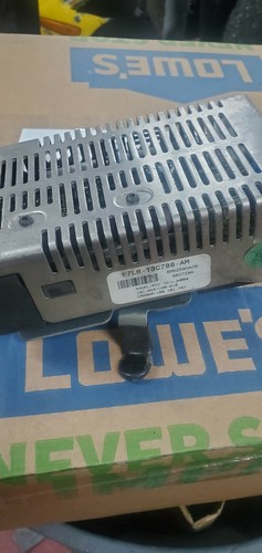

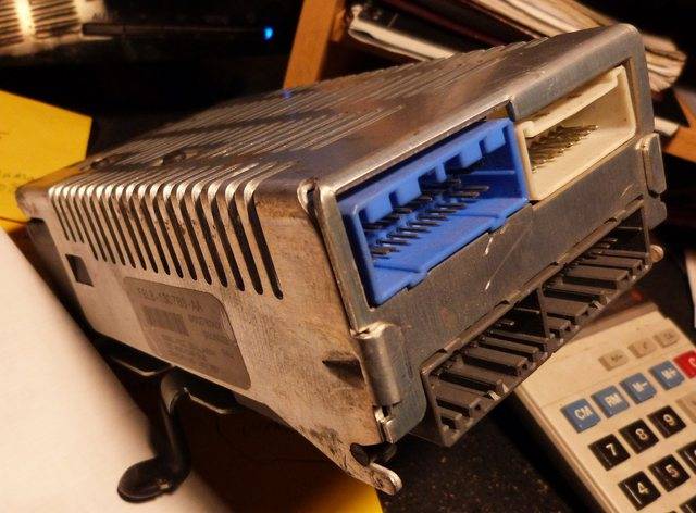

There was a lengthy post here that I read about the same issue. Come to find out the SCIL that is located on the passenger kick panel is the lock stock n barrel of the anti theft system among other things. After reading about issues like yours, I jumped on Ebay and bought one from racebronco2 in caly. There are 4 large harness connectors going into the SCIL, I would first try pulling each one and give each pin a good look for any sign of corrosion and run down the grounds for a cleaning as well. I'v not read where the PCM has anything to do with your intermittent start. There are 5 SCIL's on Ebay right now. Sure its a roll of the dice, but its all we can hope for.
Thanks. The starter is supposed to be replaced tomorrow so I will check out the SCIL now. Where does the other end of these cables go to?

Between the 4 connectors, there are 90 pins. The SCIL stands for Steering Column Ignition Lighting. There are about 40 trouble codes that can come from the SCIL. The ones for starting issues would be B1342, ECU Defective, B1353, Ignition key in open circuit, B1360, Ignition Run/Acc Cicuit Open, B1364, Ignition start Circuit Open, B1600, PATS Ignition Key transponder signal is not recieved, B1601, PATS recieved incorrect key code from ignition key transponder, B1682, PATS is disabled, U1135, SCP Invalid or missing data for Ignition Switch/Starter. The big problem is when there are no DTC's to read of course and that is how the random start issue usually pops up from what Iv read so far. As you can see if the SCIL turns out to not be the problem, the next place to look is at the PATS system. Thats the Key and alarm security lock out system the car uses in its anti theft. I believe Rapple was describing a wonky PATS quirk that he was working around. Iv never had my SCIL out but I would assume the connectors pretty much all go into the main harness stream behind the glove box. If you go to buy another SCIL, just make sure it has the same PN as yours. I thinks its a P&P situation with it but I could be wrong since its been a while since I read the write up on it fixing the guys starting issue. If you have any questions about this module, Shoot this guy a question. He is exceptionally knowledgeable about these MK8's, I got mine from him a while back.
