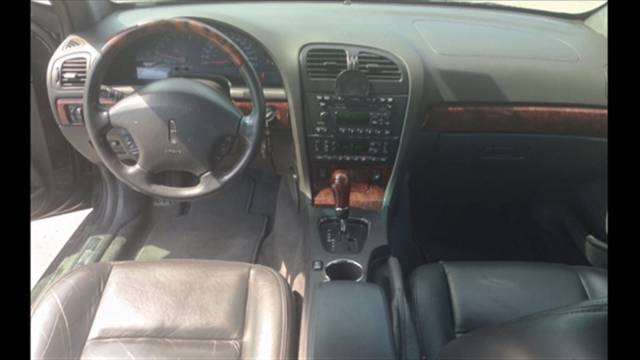

Ok so now you know me. Here's my question. The 02 v6 i want to keep is basic. The dash doesn't have the message centre, the seats have a dumb looking knob in the front to adjust stiffness, and the shifter isn't triptronic. I want to take all the upgraded parts from the lse and put it into this v6. Will it work?

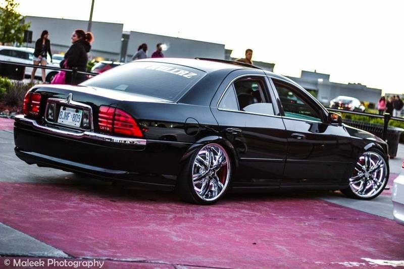

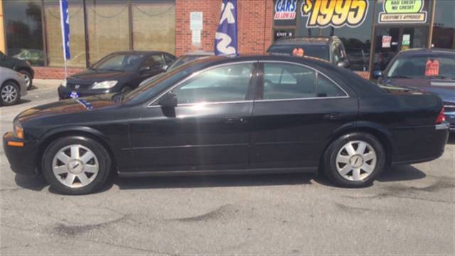

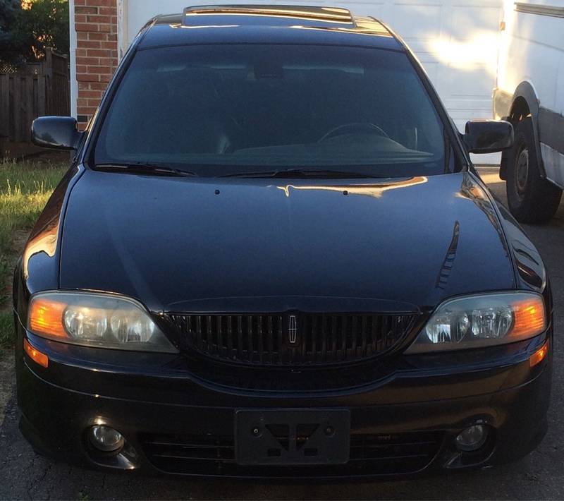

I attached some pics of my LS's. The slammed one was my first. LSE second. And the 2002 license plate I just picked up so no other pics yet except from the dealer.

Looks like your first LS had the LSE grille, but the LSE had the gunmetal teeth painted black.
"tiptronic" (Select Shift) requires the right shifter and a reflash of the PCM. Early swaps reported it was easy to get a dealer to change the code, but a recent reverse-swap (installed the PRND321 shifter) had to jump through hoops to get it done.
The message center is not compatible with V6s. At least, no one has bothered to figure out if it's possible. In the very least, it'd require the gauge cluster as well since it uses the lower right screen. I'd doubt the wires are in place in the V6 for the buttons.
I'm not sure about the seats, but I would imagine that's the easiest of the 3 you asked about to swap. Worse case scenario, you just run some extra power wires. I don't have a wiring diagram. I've never seen the powerless seat. Is it also manual recline and slide? If so, you'd probably have to run all of the wires yourself

Yea. I'm kicking myself now for not taking off the grille and putting back the stock grille. I think I picked up that grille at lsconceptz when they were around.

You have manual seat adjustments. It will require at the very least a wiring harness; as well as, obviously, power seats. They are also tied to a memory function so you'd probably need a new door panel.
The message center can not at all be retrofitted; at least not for less than new LS would cost! The sensor aren't there and you would need a new cluster as well as the appropriate wiring harness'.
You can easily add the SST shifter (the transmissions are the same). Without programming you will lose D4. If you can find a mechanic willing to do it, I can give the instructions. They are also in a thread here somewhere (on my BMW I actually was able to program in the Sport Automatic Transmission as the physical ZF transmission is the same across the board).

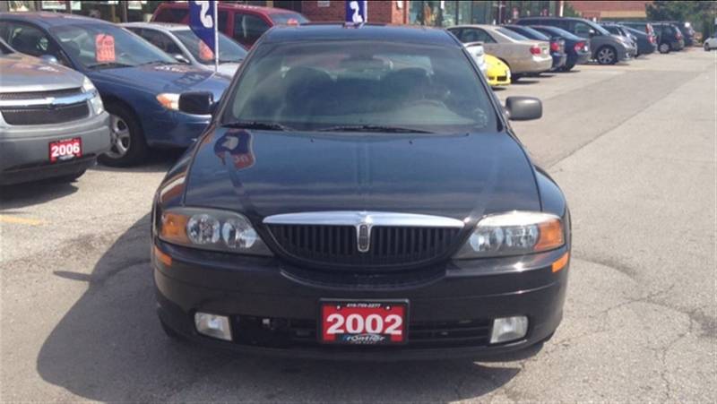

... Something I just noticed. The pictured car has a Sport front bumper, but is missing the Sport shifter? Which part is wrong?
The one I just picked up with the 2002 license plate has had its front bumper changed. The rear is still with the chrome. Bought it like that.
Have a look at a side view of the car, you'll see what I mean. And then the shifter inside.

I figured as much, just thought I'd point it out.

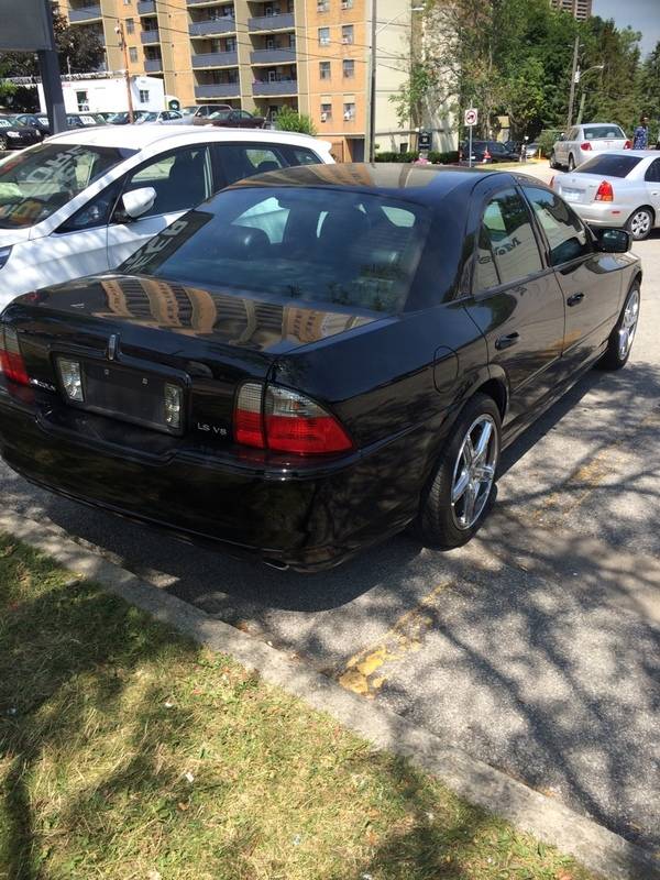

I'll leave you with another pic of my first LS.

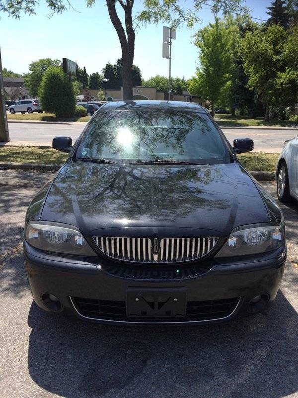

As promised, I went looking for a low mileage 06 black on black, and found one. Mint condition, driven and maintained by seniors. Has only 160,000 km on it which is not very low, but low enough considering previous owners. No engine light and drives as smooth as my 06 navigator.
It was the only one in the entire 500 km radius from where I live that was for sale, so I tried to bargain with them but really and truly, I was ready to pay asking price of $4800 CDN (which is what I ended up paying for it). Don't want to insure it yet as insurance for me is close to $500/month and I've already got 3 cars insured.
Now to start ripping apart the other two LS body parts to make this look like a gen 1 on the outside. I hope the parts are interchangeable like what was mentioned previously.
Let me know what everyone thinks and if I should start a new thread for this project. My 4th LS and 5th Lincoln :)

Looks like a set of Jag wheels...
New thread...
Should be nothing more than bumper covers, lights, headlight header piece, trunk and license plate surround. Fenders are the same.
