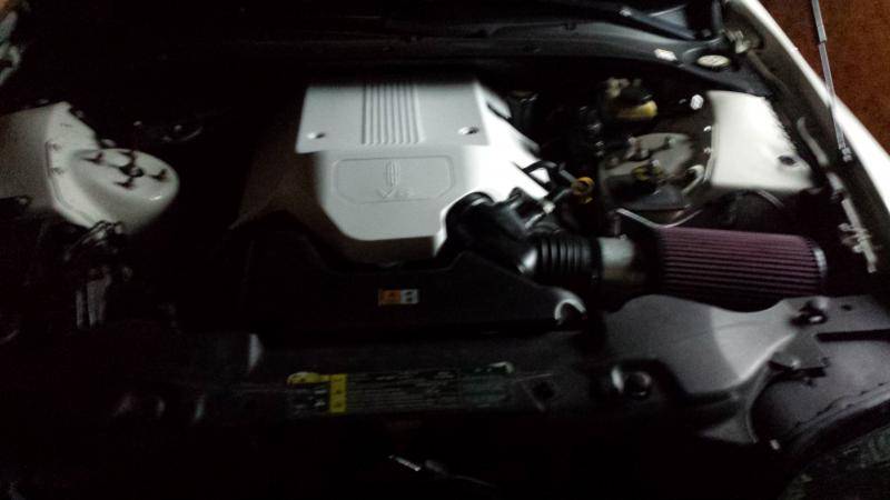

Have you considered dip, I dipped my engine cover white as you see here , and others have used red to do theirs , you can choose from a ton of colors and finishes. no sanding needed

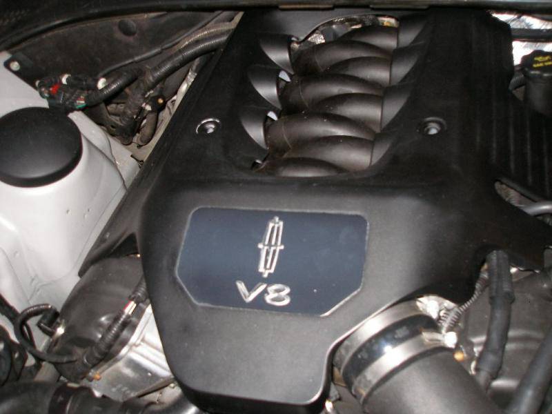

If member Rollin would chime in, you should see his underhood. When I look at his engine cover, fuse box & shock tower covers, I swear he had to have sanded it down before paint.
Never did ask him myself though. would be interesting for sure.

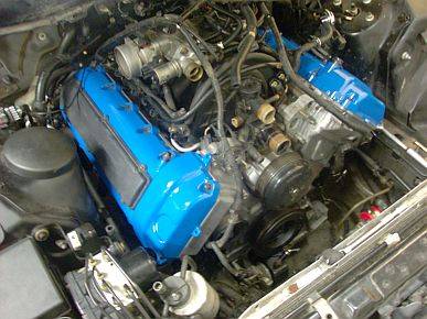

I scuffed the cover with a red Scotch-Brite pad and used primer before painting with Dupli-Color bumper trim paint......

BigRig, I've seen pics of Rollin's, but for some reason I thought he had his professionally done? If not than props to him cuz it looks pro. Hopefully he'll chime in.

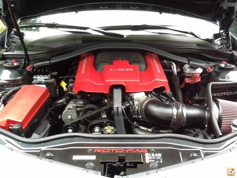

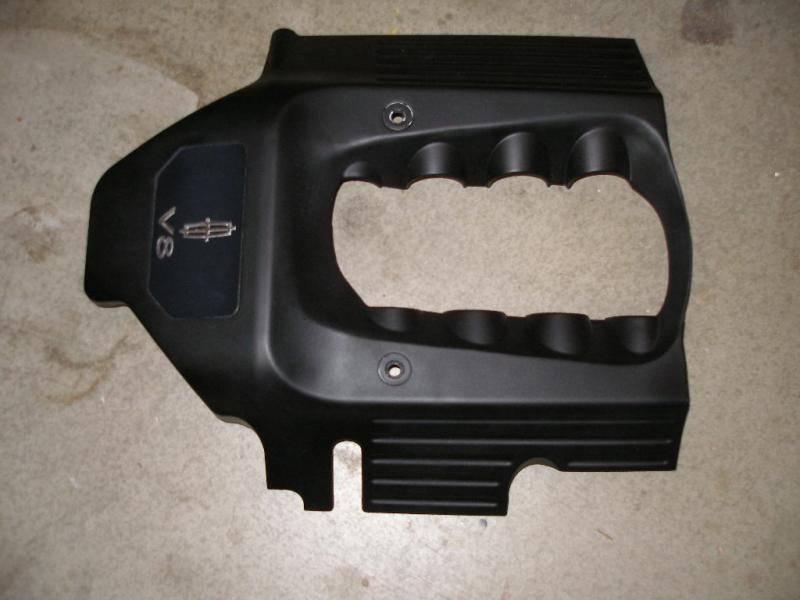

LS4Me, what year is yours? I've never seen an engine cover with the middle cut out like that? Looks killer!
if its sprayed correctly you will have no texture, its more of a temporary thing, I got tired of it and just peeled it off , if you want a legit permanent look then sanding and painting is the way to go
It's an '06, but this is a custom made cover. It is the result of a marriage between a factory cover and an S-Type engine cover. See here......

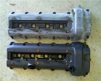

I've sanded and painted the VC's before that turned out well. An adhesion promoter like Bull-dog helps the paint to adhere to plastic pieces. I have what I did written in another post.
