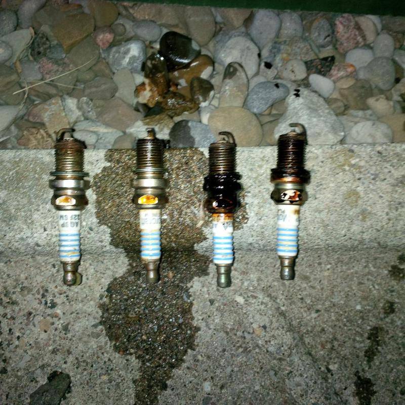

I pulled the passenger side plugs tonight and this is what they look like - (picture order left to right is: 4, 3, 2, 1) lots of oil in #2 and #1 and #3 was oily but to a lesser degree....ugh!
What's the cause of this? Off to do a LVC search now......
EDIT: Ah, looks like valve cover gaskets.
yes, you are in need of Valve Cover Gaskets.
common failure will allow oil to seep down into the plug wells.
