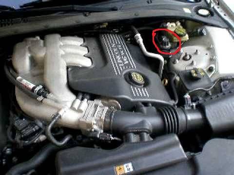

Regarding this P0442 error I'd like to look at and check the 'Evaporative Emission Canister Purge Valve' but I can't locate the thing. The DVD contents show nice little line drawings bu as usual offer no hint on where to find the thing it's referring to.
So can anyone point me to the EECPV? Mine's a V6 but I'd bet the V8 is in a similar location. To see what the DVD says look in section 303-13
The canister purge valve should be bolted to the front driver's shock mount.
If you have a 1st gen, there should be a plastic cover hiding most of it.
