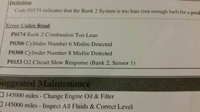

Yea I had a code scan... it stated these...
Yes,the misfires make the O2 sensor read lean,real lean,and they are richening your mixture and they will eventually plug your cats. don-ohio :)^)
