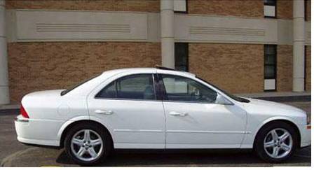

mine are 235 50R 17...

now please correct me if I am wrong, because I do not claim to me a tire expert. Doesn't the smaller first number somewhat cancel out the second number, so the 245/45/17 is pretty close in side wall as the 235/50/17. The 235 has alot to do with the width of the tire so it would make the tire somewhat smaller I doubt enough to make a difference but I don't think that the 235/50/17 would give you a larger sidewall.... Any input here would be good because I would also like to know and if this does have a larger sidewall do you have any close up pics. I would like to see how it looks!!!

The first number doesn't just have a lot to do with the width--it is the width of the tire in mm. The second number is the aspect ratio, the height of the sidewall as a percentage of the tire width (the first number), so if the first number goes up and the second number goes down, you'll have a wider tire (and thus a larger contact patch), but not necessarily a taller tire (which could be good, since you may not need to recalibrate the speedo).
So, in the first case, we have 245 x .45 = 110.25mm sidewall height. In the second case, we have 235 x .5 = 117.5mm, so the 245s will be a bit less than a half inch (7.25mm x 2) shorter than the 235s overall.
