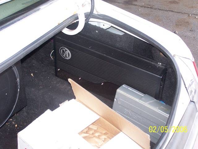

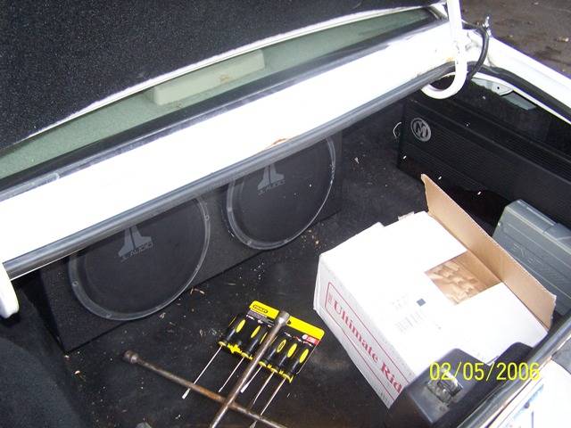

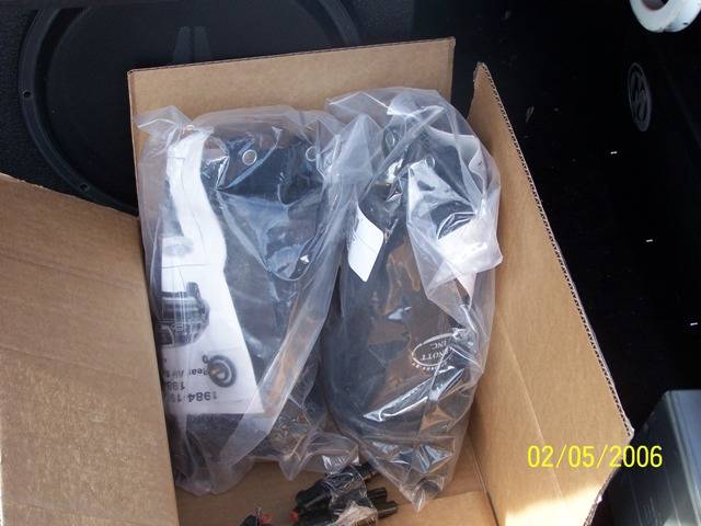

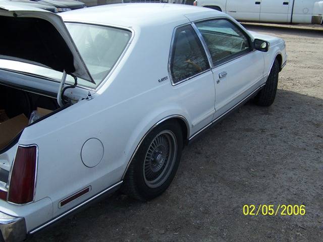

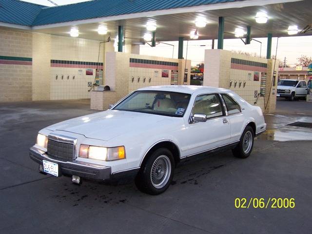

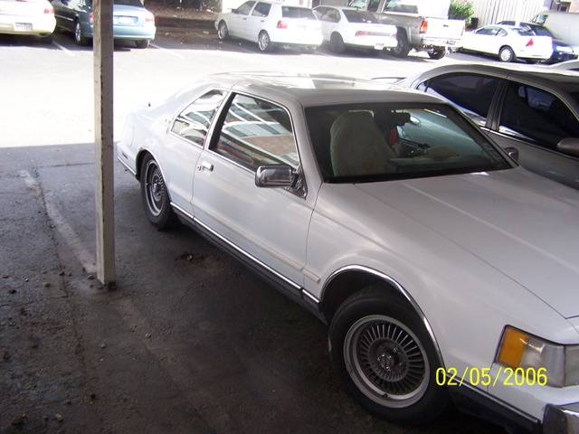

before and Parts and after the rear bags changed
i have flows(STAGE 2) on it right now and it sounds great but i had those put on the stock exhaust over 3years ago. Now i want to do it all new from the headers out the ass...2.5" all the way.
I had straight out - no muffs - out the rear corners and it sounded very nice and had ABSOLUTELY no drone.
Be aware that damn near any muff that doesn't exit the rear seem to have deafining drone on the hiway....for some reason the 5.0 is just that way.
im actually shopping around to see what i can get into on this next project. its not as much as the sound i want but really want the engine to breathe better than the stock exhaust.

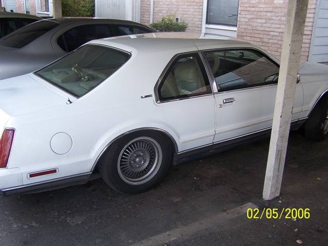

the before and after.. a$$ on ground before the new bags and noids and dryer.

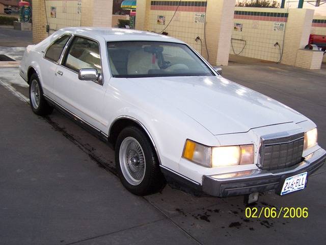

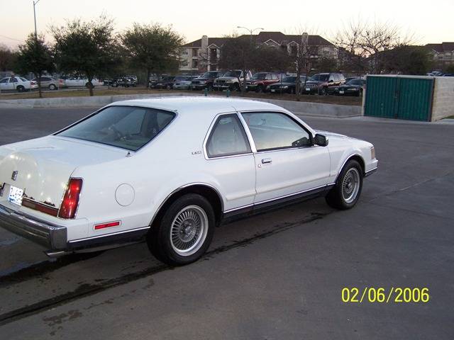

Then after new install...
Man, that looks like my ride so much, its crazy! Only difference mine has a cougar type hood scoop. I really love to see a nice white LSC, It makes me rethink my plans, which may not be realistic. Id love to have a black LSC, I just like em, but takin my white w/ blue int. and totally redoing it in and out, :runaway:
