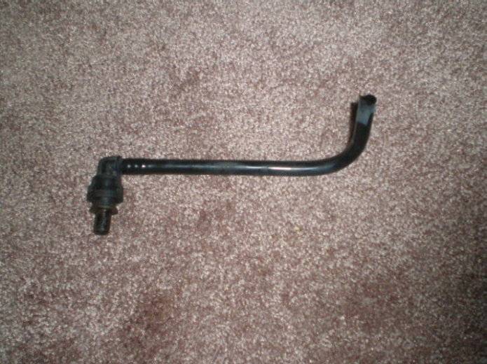

hi guys... as i change my valve cover seal today...and accidentg broke this plastic tupe. any 1 know what this tupe call and where can i go to get the replacement...please help ...
Don't know what it is for sure but the left part is a fitting and looks intact. The tube looks like regular vinyl tubing which you can buy cheap(pennies per foot) at many auto and hardware stores. I would remove the broken tube and put a new one on the barbed fitting.
You can see the "ripples" in the tube from the barbed fitting. You could GENTLY use a sharp knife or razor to split the old tube to make it easier to remove from the bars.
Good Luck,

Youll need to reseal that end fitting on that tube when you put it back on. All you should have had to do was squeeze the tabs on the ring at the end and pull and that comes apart.
The easiest way to fix that though would be to get a short length of rubber emissions hose or fuel system hose, and fit it over the broken ends of the hard plastic.

HI i did replace with the vinyl tubing, but it can't stand the high temperature of the engine. where can i find alternative?
any autoparts store will carry hose that can withstand the heat and oil vapor.
All of mine are swapped for hose since I added the oil catch cans in-line to the PCV.
The vinyl tubing used in cars is usually a hard shiney plastic vinyl. YOu don't want the soft rubbery feeling vinyl tubing.
Look around at the bigger stores or try a NAPA store, they often have the less common stuff.
There are also commercial hose supply outfits in most industrial areas and they have all sorts of hose with different materials. The shop can usually point you to the right kind of hose. What you are looking for is fuel and oil proof and temperature resistant hose.

The same thing happened to me. For some reason, I had to go to the Ford dealer instead of the Lincoln dealer. For some reason, the prices are cheaper at the Ford dealership too. Anyway, the part number is W701520-S421 (if it's a V6) as of last October. It cost me $3.00. But, if you want to go cheaper, just stick that part number in the search at TeamFord or something. Hopefully, the part number is the same. I noticed Ford/Lincoln seems to change part numbers around often.
