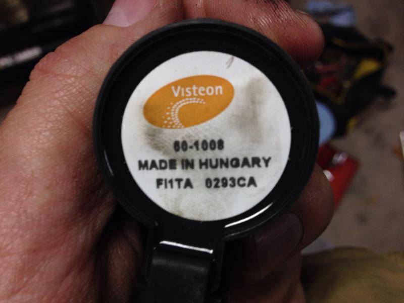

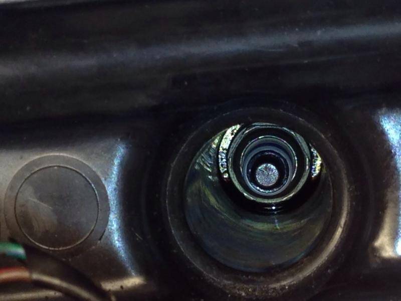

Got a Cylinder 1 misfire today. Pulled coil cover and removed the Visteon that was installed only 3K ago, looked perfect no oil on it.
In spark plug hole there is only the slightest half-circle shaped dark spot, prob oil, but very very little.
Could that tiny spec of oil cause a misfire? And has anyone else had a Visteon go bad so quickly? image.jpgimage.jpg

Doesn't look like enough oil to be a problem. Did you use dielectric grease on the boot of the coil? Is the plug gap at 1mm, no more and no less? Was the plug changed with the coil 3K miles ago?
Yes on dielectric grease, will check w my mechanic on plug specs.
Edit: my notes say plugs changed with sp467 platinum w correct gap. Will pull it to inspect.
Strange choice. Why not go with the specified SP-497 plug?
Edit: Looks like 467 used to be called out, but the current number is 497.
Plug looked fine and gap was good.
Cleaned it off, reinstalled, cleared codes and started up. Misfire came back.
Motorcraft coil and plug on order...
Could be a fluke failure. Is it possible that someone sold you warranty returned coils as new?

These were part of one of those trusted eBay sellers' listings around a year ago. Oh well, we'll see what happens when the motorcraft gets here. Thanks Joe!

Well a new Motorcraft coil fixed it. If the rest hold up for awhile the cheaper Visteons were worth it.
If more start failing I guess they weren't. Time will tell.
I obtained my Visteon's from the guy on ebay - alansdeals before he stopped selling them. Been about 40,000 miles and no issues. The only thing I've done is VGCs and changed the plugs from motorcraft to NGK.
Been rocking visteons for like 30k at this point. No problems, sounds like you just got a bad one, it happens, even with the best manufactures.
Hopefully a fluke. Glad others are getting good results with theirs. I also bought mine from alanisdeals, but I only have 9,000 mi on them so far.
