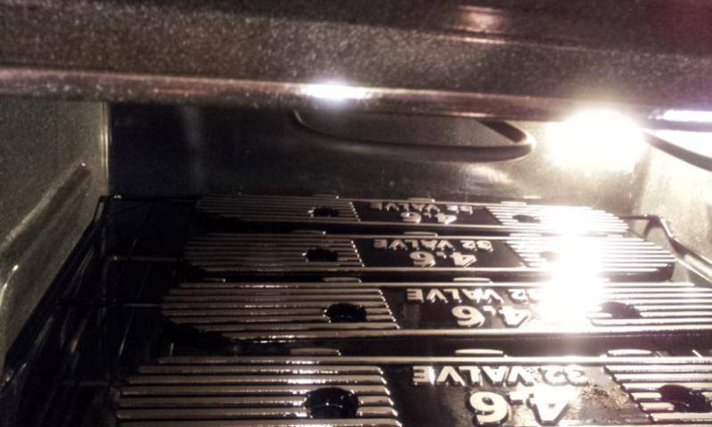

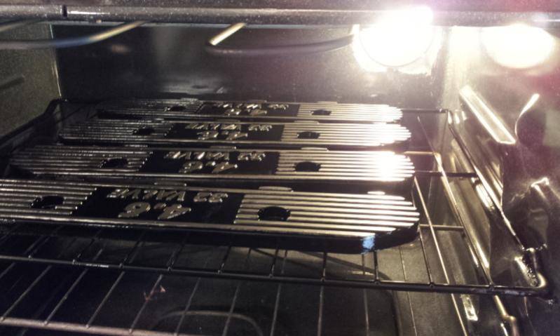

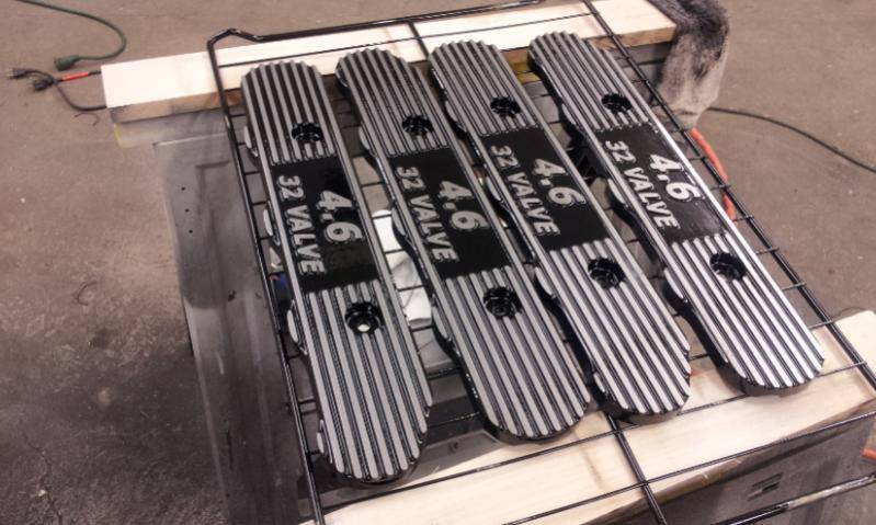

Today I did the coil covers. Shot them with the smoked chrome and then with black cleaning off the fins. Final coat was gloss clear. Turned out pretty good.

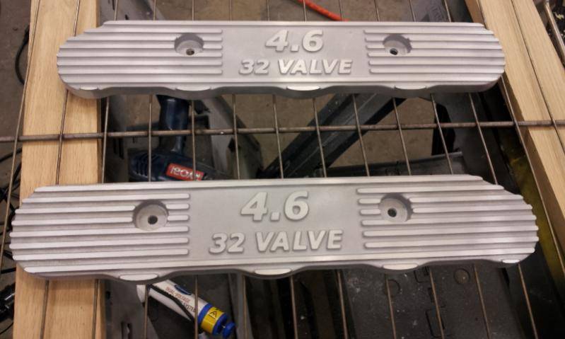

I'll take it from the top. These are aluminum so I blasted them with aluminum oxide, scrubbed them with hot water and soap; them dipped them in boiling water. I also degas them in the over for 45 min at 475*.
Why.. Because I don't know what they made these out of.

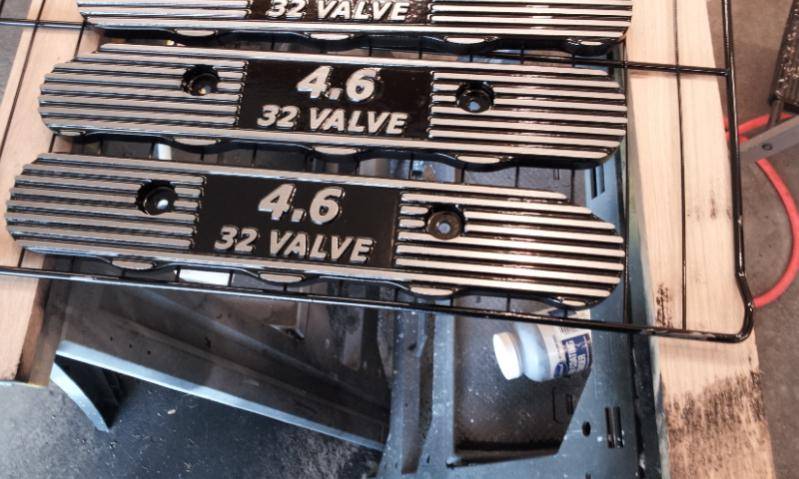

Set the oven to 450* shoot a coat of smoked chrome, set them in until the powder flows out. (Do not cure)
Let them cool and shoot the black, wipe the parts you don't want black.
Return to the oven at 450* until it flows out then back the oven down to 400* for 20 min to cure.
Pull the parts and let them cool, shoot the clear and return to oven already at 400* until it flows then back the oven down to 375* to cure. I have the low temp clear to use over all powder including chrome to retain the shine.

I take a damp cloth and use my finger.. With a nitrate glove on and a small artist brush. The damp cloth is to wipe the powder off the brush and my finger.

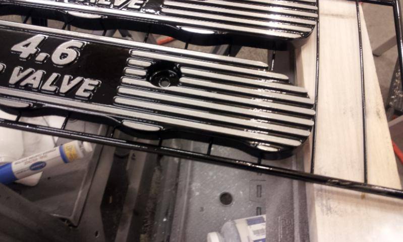

The smoked chrome looks great, the first set I did had a couple pits in the casting and the coverage of the black was a little thin in the sides. The second set turn out fantastic, did a little research and know how to fix the pits in the aluminum now.
