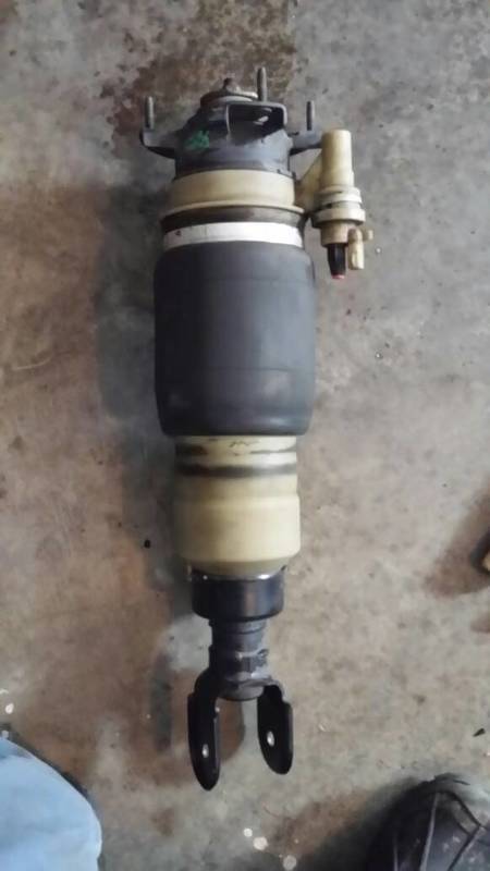

I went to pick and pull and paid 30.00 for drivers side front with solenoid. That might be a choice as a backup.
I was going to do this too, but the yard wanted $80 for each shock and how can you test them, with the wheels off the car? I could bring a battery and run the pump. Still be pretty hard to tell if all leaked out with no wheels on the car.
Pick n pull out here gives you 30 days to return them if they dont work. And 1 year if you pay 20 bucks. Mine were actually still holding air while I was taking them out.

So far so good.they've been in for a week now
wow that looks to be in pretty good condition. Mine will lower a couple of inches if she sits for a week without being driven. I still think it could be the o rings, but have been told otherwise by members here. Just seemed odd that when the battery was disconnected and not driven for over two weeks they didn't lower, but with the battery connected after that lowered couple of inches in a week.
I will ask them if will give me a deal simular to what you got. I would have to drop them in after purchasing to test them and may have to put my originals back in...not sure I want to go that route yet.
