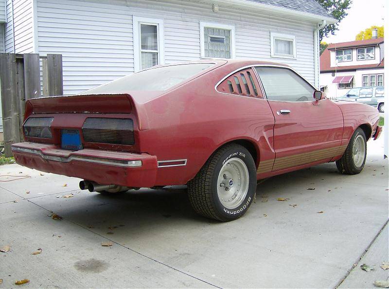

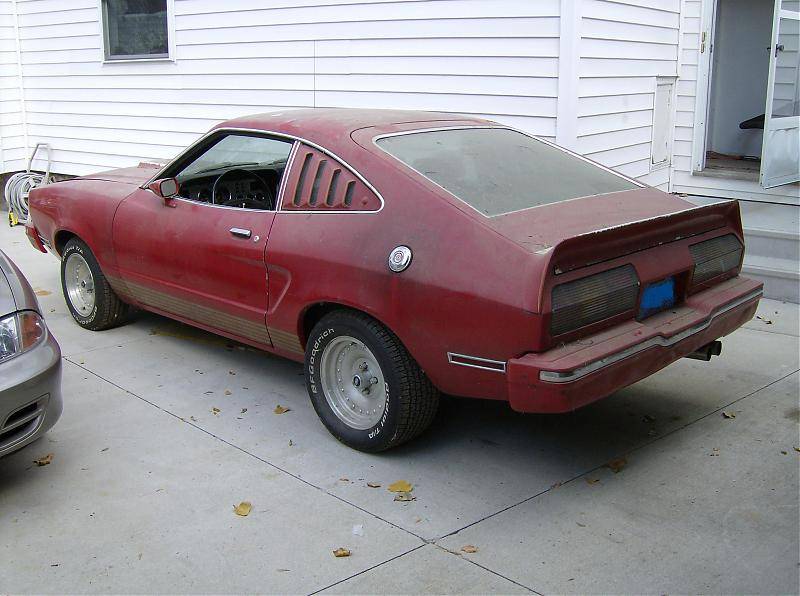

Pulled this thing out of its hidding spot today. Its been stored in one of my brothers garages for several years. Fresh motor, just need to finish fine tuning the carb. It likes to coil up the axle and trash u-joints if you get on it so I have to change the leaf springs first before anything. Maybe this winter...
Anyways snap a few shots as I don't really have any pics of it.

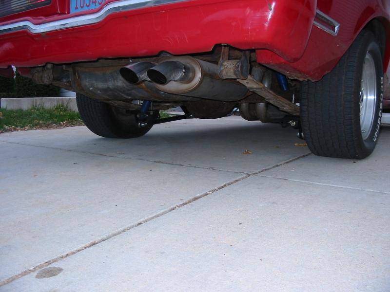

2.5" duals, X-pipe, MangaFlow 2 n 2 out

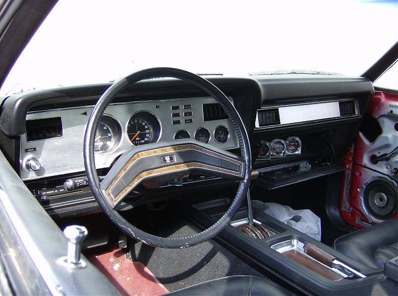

Cars lookin good needs a good clean up though. I see fake wood trim, is that thing have the Ghia sport Package on it? Too bad you don't have the tilt up/take out glass sunroof on it, or the T-bar roof with the lift off glass panels, always liked the look of the T-bar roofs on the Mustang II's.
True LOL. you could be a MR2 fan or something.:p
The early Cobras had the same steering wheel, shifter, e-brake and tray as the normal cars. Some had center consoles some did not. This was a white/blue stripe with black interior and a auto trans, first batch made, hardly rare though they sold tons of these things. Manual trans, other colors came later. 77 Cobras got the sport wheel and the column, shifter, e-brake were always black. I stripped a 77 years ago and have all the blacked out stuff for it, should look better.
I also have a T-top roof with glass. Adds alot of weight to the car and weakens it. I could see twisting the car even with the mild plant in there now. Only hatch models could get the T-tops. Don't know if I will ever use it in anything.

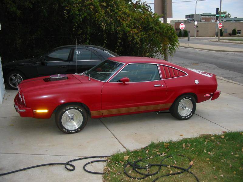

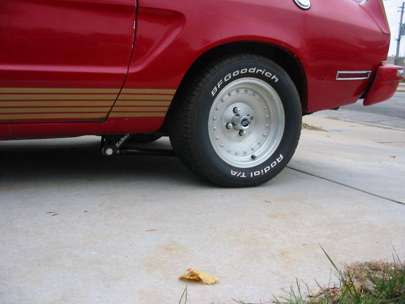

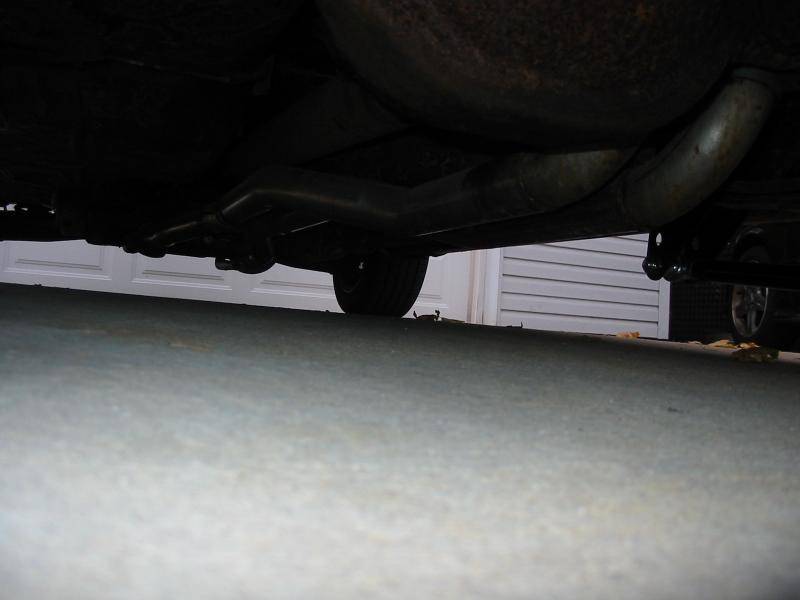

Got this thing up and runnin about a month ago. Swapped the rear springs with a newer set I had laying around. Caltracs custom fitted to the stock perch with 9/16" U-bolts and all factory rubber and such was ditched. No more axle twist. Still have fine tuning but jetting up 4 sizes was the major turning point in getting runnin good. The 670 Holly Street Avenger is supposed to be "out of box" ready. With the tiny jets it has in it out of the box my car would hardly run. Adding a regulator was a must, bigger jets were a must, a more aggressive acelerator pump cam seems to eliminated the quick throttle hit hesitation, still toying with secondary springs.
Its been fun to play with. Heres a couple pics from today.
