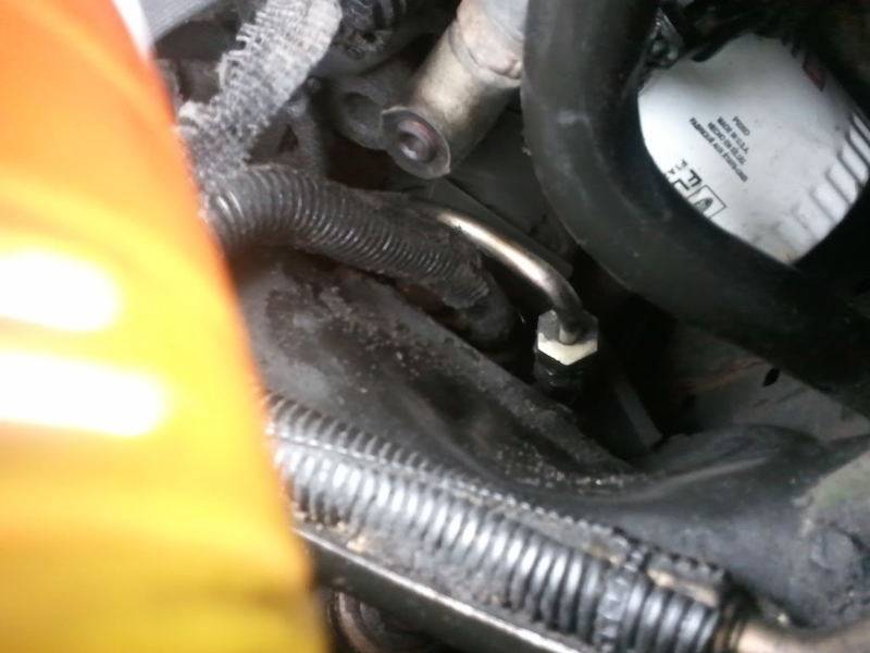

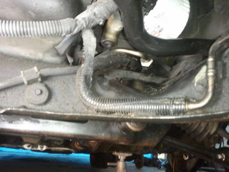

I think the pictures give you a good idea of where the leak is at.
The leak is traveling down the base of the steering column so I'm betting it's the connection of one of these hoses going to the steering column.
Looking at the diagram the part numbers:
3a713 3a719 are the two metal hoses that attach to the steering column (at the bottom).
Anyone ever replaced one or both of these metal tubes while the k-member and engine still in the car?
It's either I replace it or a mechanic does and I'm scared of a mechanic touching it now. (plus the 1000$ bill).

No it's the other side of that metal tube where it attaches to the steering rack. The leak is coming down the steering rack.
