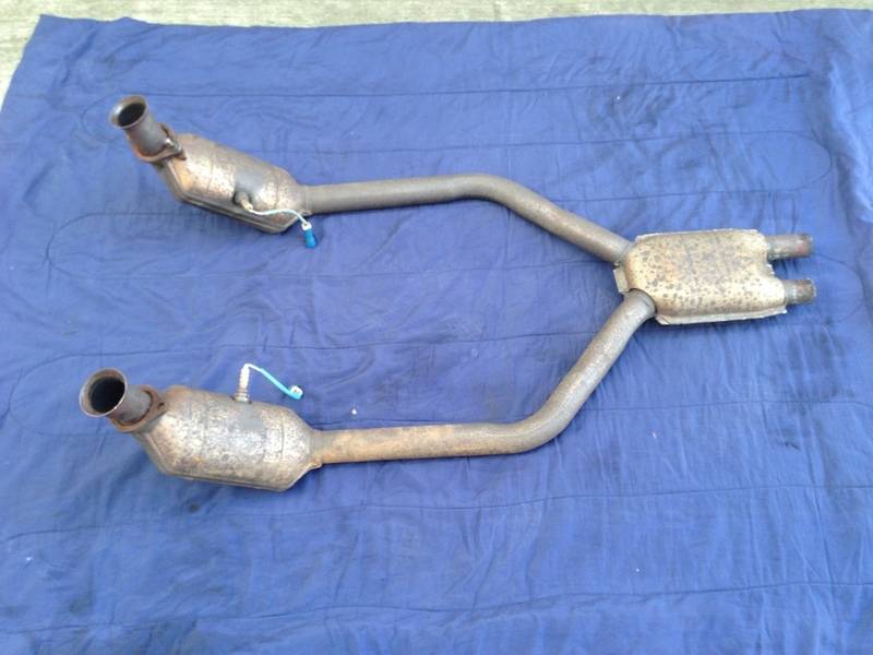

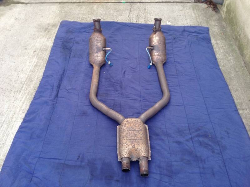

I picked up a pair cats from a wrecked 03 V8 for pretty much the value of scrap, so I didn't think twice. Worst case scenario I scrap them and get my money back.
Anyway, I'm currently running Thunderbolt hi-flow cats and they don't seem to be running optimally. I'm getting terrible gas mileage. They set of a P0420 code twice and a P0430 (original o2 sensors) once. I cleared them and they haven't been back in almost 2k miles, but I came across these OEM cats and I'm considering switching them out.

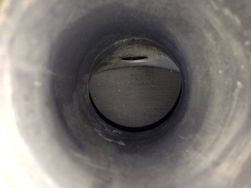

1) Is there anyway to tell visually or test if they are "good"?

The donor vehicle had 86K miles. I know at 86K my LS was running well and I looked at the engine of the donor LS when it was still on and it seemed pretty sanitary. The coil cover bolts seemed to be unmolested, so I guess that could be good or bad. The guy I picked them up from owns the shop where the car is and knew the owner of the LS. Apparently he babied it and was running properly until it was totaled. One thing that concerned me was that the cats were sitting out in the car without the engine for a while so they did take some rain water and snow...

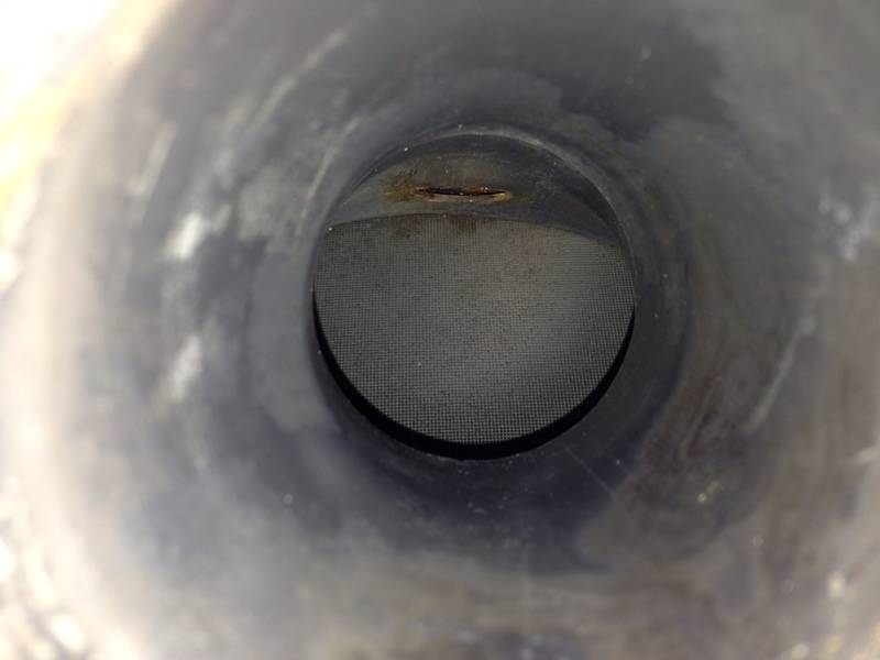

If those CATs were bad you would see it when you look down the tube the bolts to the exhaust manifold. They look good to me. I will be doing this soon as well. My Thunderbolts are giving me the same probs
Yes that was the drivers side on my LSE. I dont know if I have ever heard of washing your CATS...gotta love Scotty Kilmer...lol
