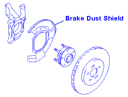

he meant "backing plate" as in the dust shield! (I think)
like so:
they can end up rubbing on the rotor when bent.
That's what I figured he meant - thanks for the illustration! Unfortunately it's pouring here so it looks like it'll have to wait until tomorrow.
