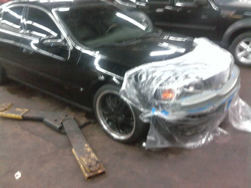

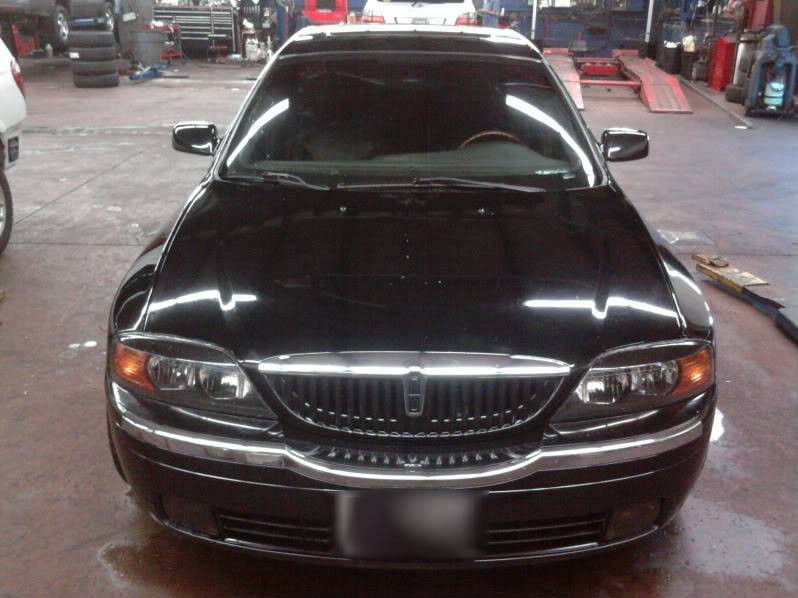

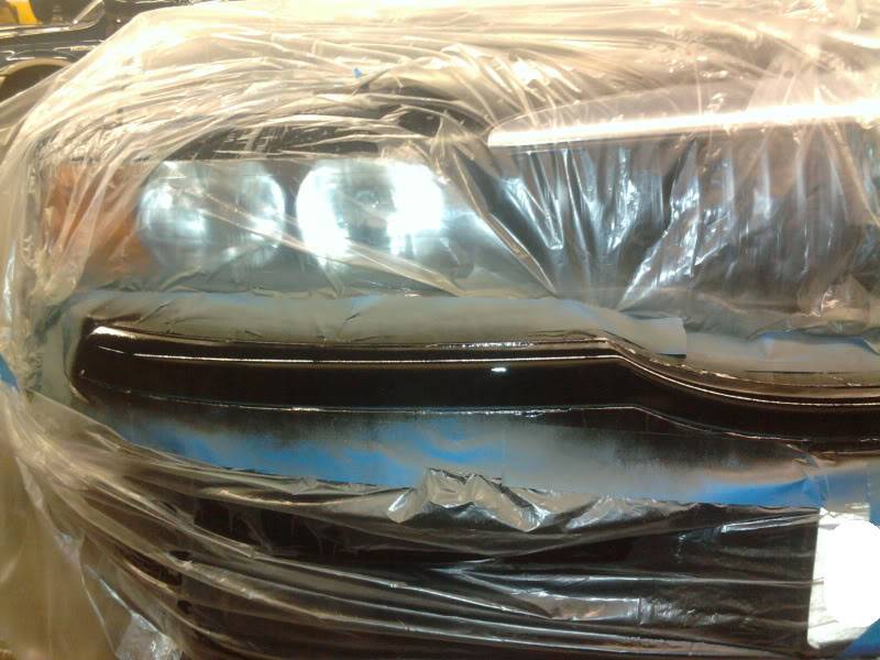

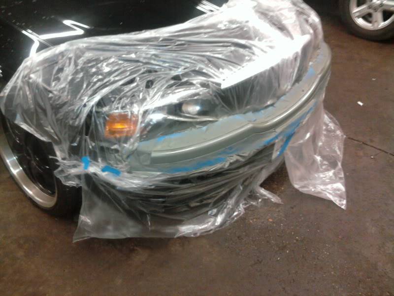

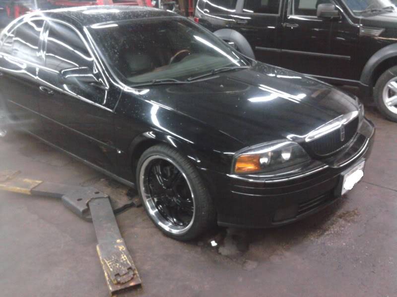

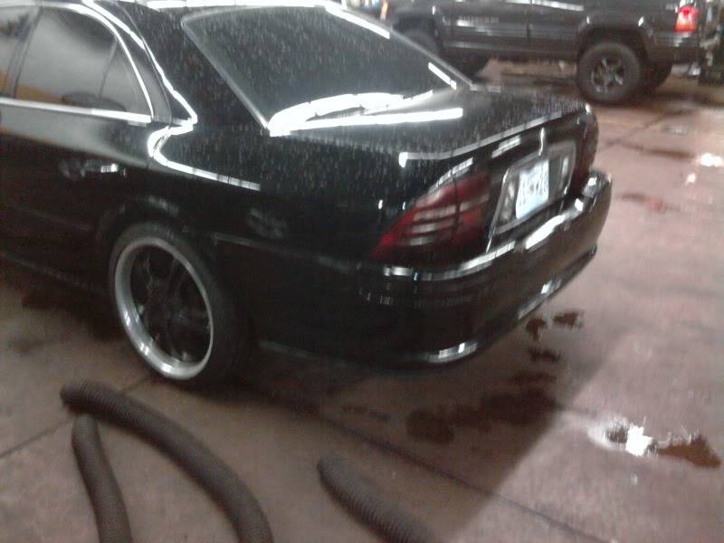

Finally painted the chrome on the bumpers, now it looks like a sport model lol.
Still have to get the rear surround and top part of the grille (this week)
BEFORE
AFTER
thnx for looking
Looks good. Hopefully it will last. I would like to do that to mine. Did you use self-etching primer on the chrome?

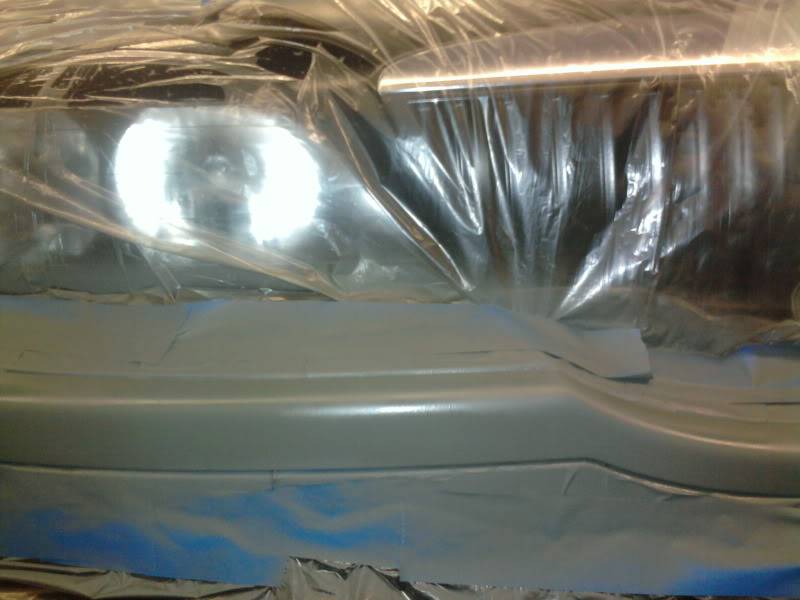

i hope so too. yea, i used self etching primer.
scuffed it up using emery cloth, went across it a couple times with 00 steel wool (didnt have a clean rag around, just used to remove loose dirt/shavings), 2 coats of self etching primer (army greenish color), 3 coats of black paint, 3 coats of clear
Nice... Looks much better without chrome on a black car. A clear polyurethane or flexible bumper paint may add some durability?
