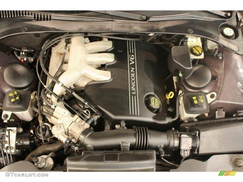

If you can see the coils on the driver's side (under the appearance cover) and the intake plenum lays over the coils on the passenger's side you have the V6 (honestly that's something that should be ascertained prior to purchase). 2001 V6 engine (disregard the bottom pic. I can't remove it!):

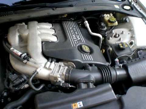

Macc, I can understand how its frustrating. I never did learn much how to repair cars, just watched the man who raised me maintain cars from the 60's and 70's. Here I am now starting to do some minor things to save money on my 2001. First, you should be able to tell the engine size by the plastic cover on the engine like the pics here, or if its V8 it says very prominently on the rear brake light 'LS V8'. I guess there is a small chance the V8 would have been removed, but then the vin run through CARFAX will solve that.
