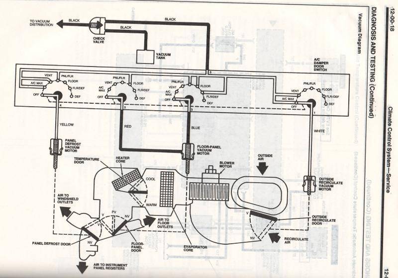

anyone know if I can find the vac leak with a tester (Mighty Vac style) on each of the 5 (R,W,BL,W,Y) hoses coming off the EATC?
could improper installation of the BDA cause the system to go into failsafe mode;

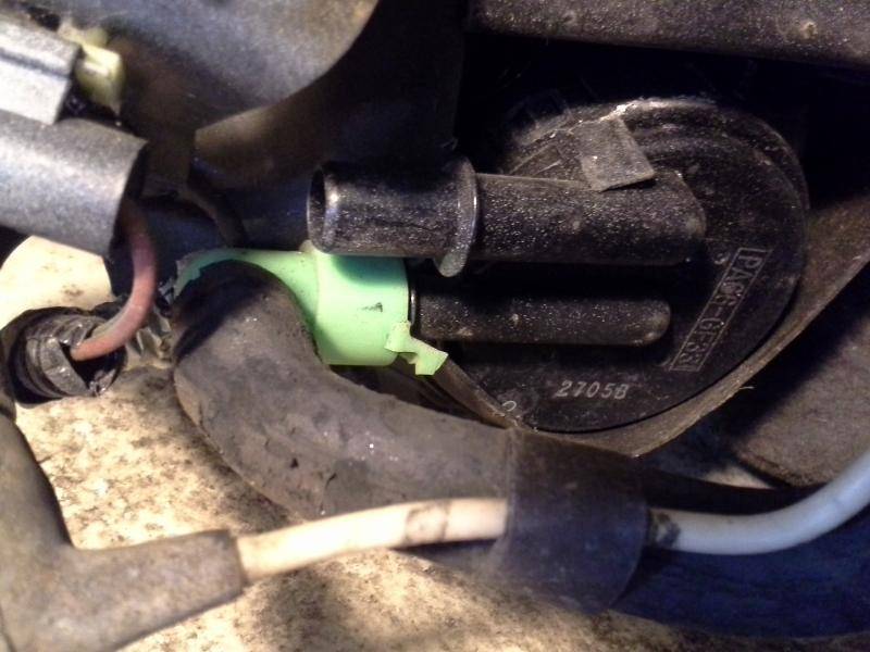

where is the AC vacuum check valve located???
It has three ports:
1 for the intake manifold one for the reservoir and one for the control assembly/eatc. Is it located behind the passenger wheel well liner?
thankfully i found the vac check valve (behind pass front fender liner) before pulling the dash again, my leak was plain as day; somehow one of the lines (to the EATC) had been forcibly removed from the check valve; made the connection, problem solved re; getting out of fail-safe mode
no idea how this happened
I am glad you solved this problem publicly - it was good schooling for all of us, and I especially appreciate the diagram. Pictures are good.
this fix is somewhat of an anomaly....i mean, how in the HEEL did that vac line at the check valve get knocked off of there? at least i didn't pull the dash needlessly
