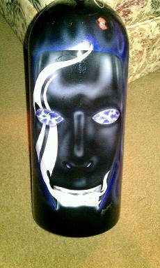

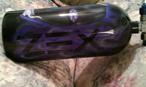

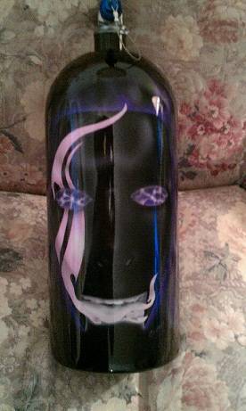

I know this is a touchy topic because everyone's taste is going to be drastically different when it comes to custom work. But, with that said, I had the bottle, as part of an entire system from Cammerfe, painted and airbrushed. I did contemplate putting the Lincoln emblem on it and nothing else but held off due to the thought of ever trying to sell it with that emblem and a potential buyer not having a Lincoln.
Thought I would share a few pics as I was happy with how it turned out. The one really bright pic is with the flash on so I could get a bit better view of the facial features.

Thx guys. Honestly, it is out of my normal taste zone as well but I wanted to say "f it" and do something a bit different on purpose. It isn't normally going to be seen so it gives my trunk a bit of of a conversation piece since I just have a single prefab box with a 12" sub in it. In other words, I found my trunk boring. LOL.
