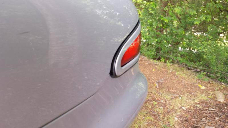

Rear tail light trim sticking out a bit ... not sure whats going on with this

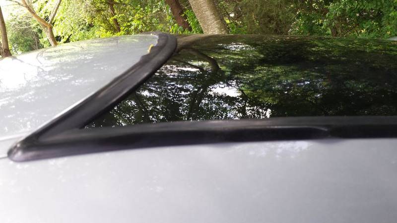

Crappy rear window molding ... almost didn't buy the car because of this.

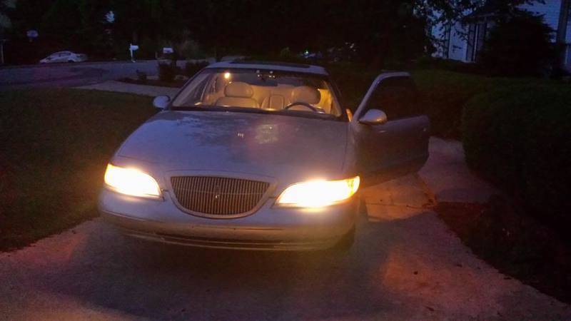

Non HID headlights

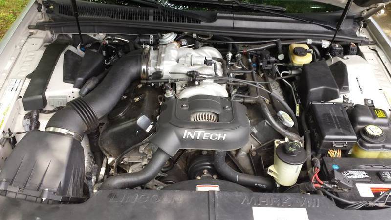

One last pic, the 32V v8 .... ftw.
The rear tail light might just be a nut the needs to be tightened or put in.
The rear window seal is a common problem. It is not going to cause it to leak but it does look crappy. There is a repair kit but the best thing is to replace the whole rear window. Here is a good link.
http://www.lincolnvscadillac.com/fo...88-Rear-Window-Trim-Repair-Temple-Performance
Looks like the previous owner got the OEM HIDs replaced with OEM halogen headlights by the look of how new the headlights look. They stopped making our hid bulbs so they started offering these as replacement. These are rare and must have been expensive. But halogens suck. You might just need a aftermarket hid kit and don't probably even need the adapters since yours are OEM halogen headlights.

GET THE HID HEADLIGHT KIT FROM THIS MAN!^^^ You will NEED an adapter to make any aftermarket kit fit your car! He makes the adapters himself along with modifying the kit to make it specific for your car. Other then that welcome to the forum. Cup holders are notorious for breaking. I'm just now diving headfirst into my front suspension. May want to check the "Does this look safe to drive" thread for part recommendations. Great looking car though man.

The HID kit I sell is a full plug-and-play kit that plugs right into the factory plug, and includes a set of adapters that I make, as well as a set of aftermarket HID bulbs and ballasts. I sell the adapters for $50 shipped, and the whole kit (including adapters) for $165 shipped. Although as mentioned above, if you have the Ford Halogen Retrofit Kit, you likely won't need the adapters. The other part of the kit would work for you though, since the factory plug remains.
As was mentioned above, it may just need to be tightened up. There should be 3 nuts on the inside of the trunk behind the taillight beneath the trunk carpet.
Unfortunately, there's not really a GOOD fix for this, short of getting a replacement window. Temple Performance sells a kit that might help you, and would be worth checking out. It'll help with the ripples, but if the rubber is dry-rotted, it won't work. Some people have actually cut the edge of the rubber off, with decent results, but it depends on how it looks as is.
Non HID headlights
The headlights look to be in really good shape, and if they are the retrofit kit headlights, then they're actually pretty rare/expensive. The last price that Ford sold them for (if there even any left) was $1900!! I've actually got a couple sets of them, one set is even brand new--never been installed in a car.
Anyway, an HID kit should work in those housings no problem, and it's something that we could do VERY easily.
How would I know if I have the Ford retrofit kit and don't need the adapters? Do you have any pics of the headlights (at night)? If my headlights are the Ford retrofit ones, that would make feel somewhat better for paying $3k for the car. Not sure if that was a good deal or too much???

As was mentioned above, it may just need to be tightened up. There should be 3 nuts on the inside of the trunk behind the taillight beneath the trunk carpet...
Will check this out when I get a chance.
Can you still get new replacement windows with that molding???

has anyone on here used the Temple rear window repair kit?
Easiest way to tell would be to take them out and look at them. I'm not really sure how to tell you, but if you could take a picture of the wires coming out of the low beam socket on the headlight, I could tell you. Not a bad deal at 3k.
I think so. Check out Tasca Ford, or Tousley. I think they had them listed for fairly cheap. (about $400, IIRC)
