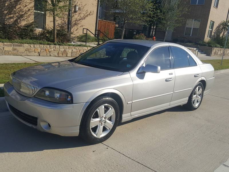

New to me 2006 LS Sport
inurok
Apr 5, 2005
29
Texas
Runs pretty well for having 175K miles
So far issues I have are
Drivers Mirror and keypad Dead
AC sometimes blows warm out one side with burning oil smell thru vents.
Engine clatter on cold for like 2 seconds
Oil leak near front of the engine.
CEL says bad driver side cat.
Pretty peppy car but I expected a tight feeling car. Could be due to the front end rattle I hear over rough roads
I should have dome my research but I will work with it.
Btw is it normal to get like 16.7mpg ?
Thanks
