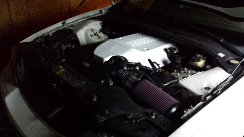

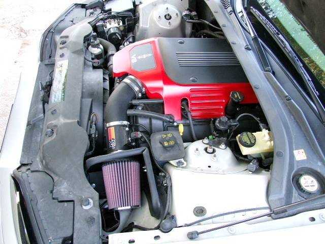

That's awesome thanks man, do you have any pictures of your engine so I can have an idea of the custom intake?
the one with white engine cover is mine , the last pic is of the KN intake system on one of our members car
Ok so on yours, what did you do? Keep the stock pipe? remove the filter box and just add the cone?
I bought a KKM adapter from a member on here , I think spectre makes a adapter for 20 bucks , and I slapped on the biggest K and N filter from my job on this , really grows for sure , I have to build a heatshield for the when the hot weather comes
Ok, so your maf is connected to the adapter? Or is it attached in front of it, I can't really tell from the pic, I think I might just go your route, most likely going to build my own

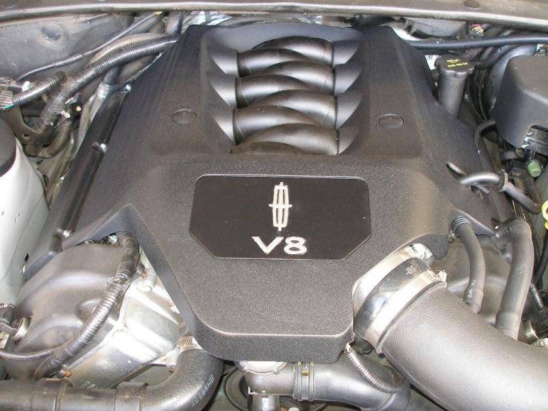

I have seen the red painted engine cover somewhere. :shifty:

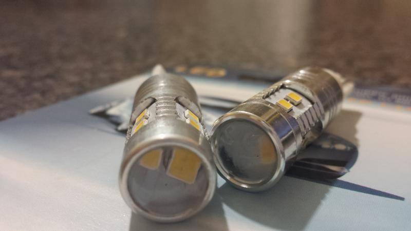

Leds for sure , I have reverse leds, license plate leds, and high beam leds

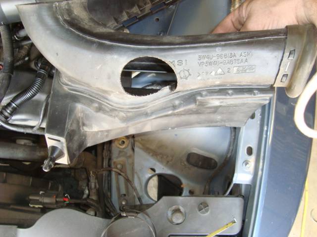

I did a simple cold air setup to get rid of the noise reducers and restrictive MAF to TB pipe using stuff I had laying around the shop.
I also cut the bottom out of my stock air box so it could draw out of the wheel well area. I put a piece of foam between the air box and the fenderwell to keep hot engine bay air from getting to the engine.
I'm not a big fan of open element air cleaners hooked to metal plumbing in the engine bay as the filter just suck hot engine bay air and after the pipes heat up even with a heat shield the air is getting warmed up above ambient.

and ghost, the ladies look pretty sweet what's the wattage on those? will let would I need any type of harness with those?

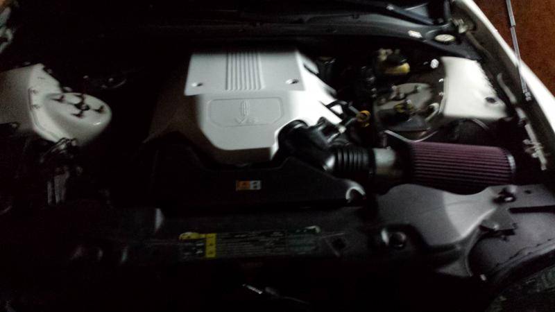

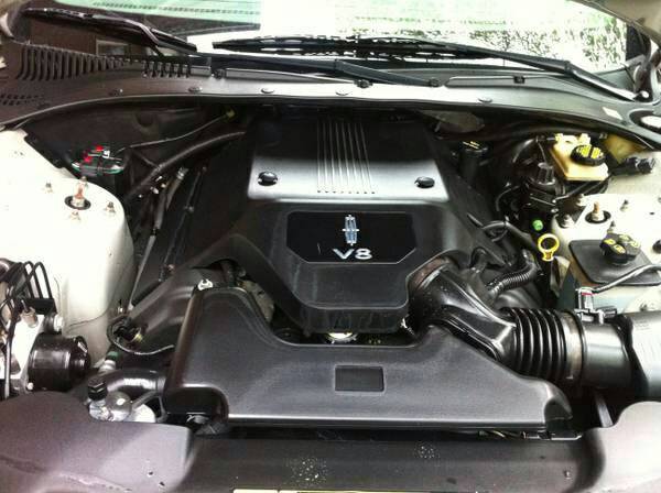

This is what my engine looks like now View attachment 828465962
Then this is what you need.......
That's why a heat shield is used. Almost all carburetor cars had the air cleaner right on top of the carburetor sucking in real engine heat! The air isn't in the tube long enough to absorb any heat from the engine bay. The speed of the air being sucked into the engine causes it to heat up a little on it's own.
