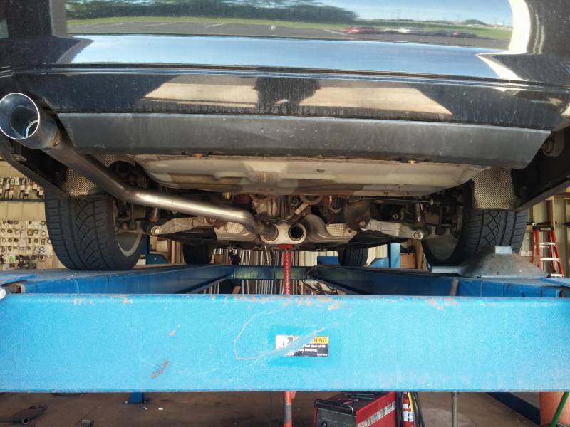

I got my exhaust system installed this morning. It's a Dynomax Ultra Flo-X dual in dual out with the built in X pipe, 2.5" pipe out the back, and all stock resonators/crossovers whatever removed. I put some silverline 3.5" double walled tips at the end. I was concerned about it fitting ok, but it slides in nicely where the resonators used to be. You can see the install pics it does hang lower than the surroundings, but not by much. I shouldn't have to worry about it hitting anything, especially on my non-lowered car. One major reason i went this route was cost savings. The muffler was $110 shipped, tips $80, and $180 to install it all. The bassani mufflers alone would be nearly as much as my total install.

Here's the install halfway done.

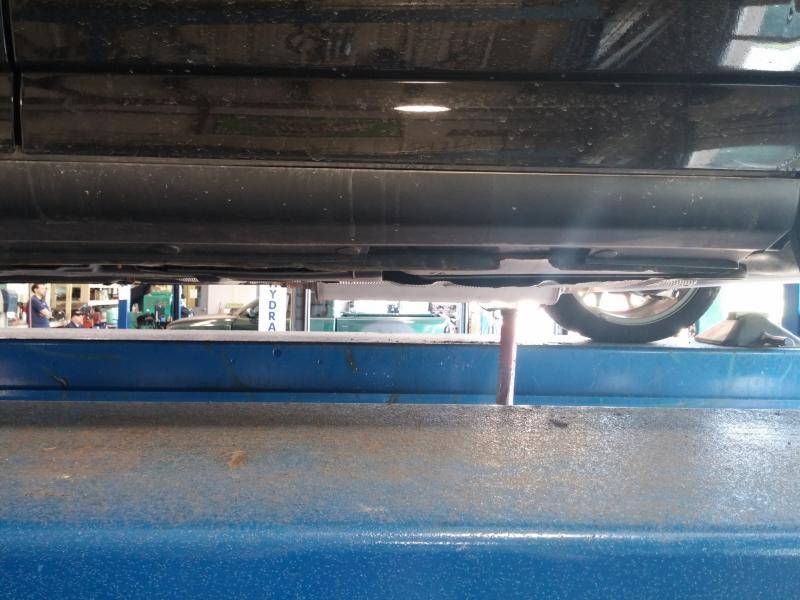

Here's a shot at how low it hangs.

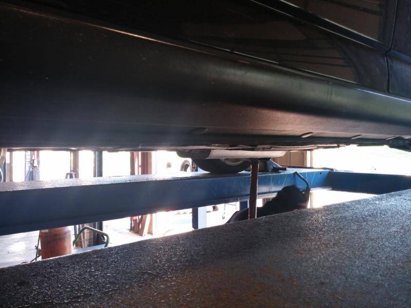

And another angle

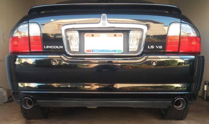

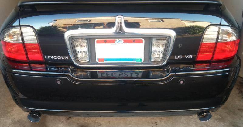

And here's how they look on the car.

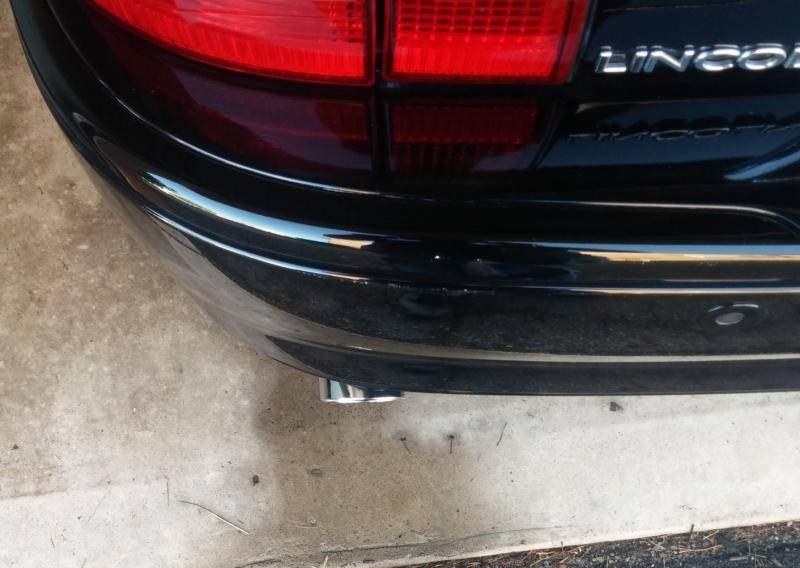

The tips stick out a little, i asked about making them more flush but he didn't want all that piping hot exhaust damaging the bumper.
I'd be worried about bottoming out on that,
that's just me, Does sound nice for sure! +1

looks good!

Thanks guys! I took some measurements, the muffler is 4 3/4" off the ground, or roughly 1 1/4" lower than anything else around it. Not ideal, but nothing I'm too concerned with. While we do have huge potholes, there aren't many speed bumps around me to bottom out on.
