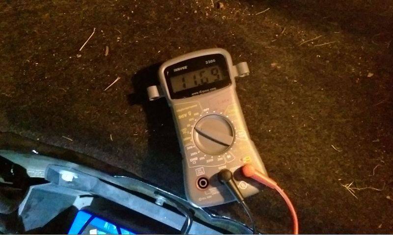

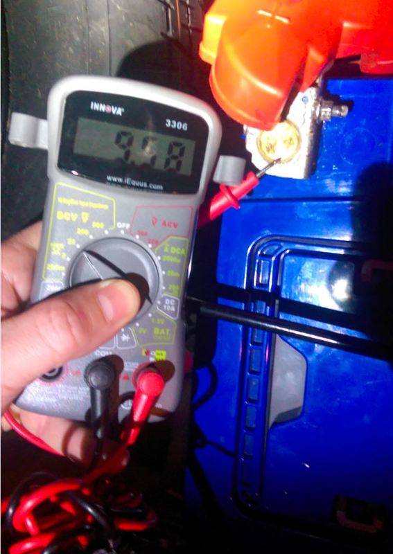

  • Installed the battery and tried to start the car, dim interior lights and no start. Tested with volt meter and it read under 10v while connected. Disconnected and it was reading 11.6ish Weird. Rechecked the terminal connections, seems fine.
  • Jumped the car and drove 10+ miles at highway speed with no accessories on to try to charge it up a little. Parked the car at 2:00 back at work.

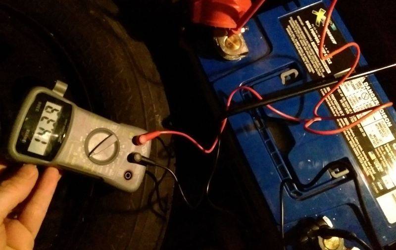

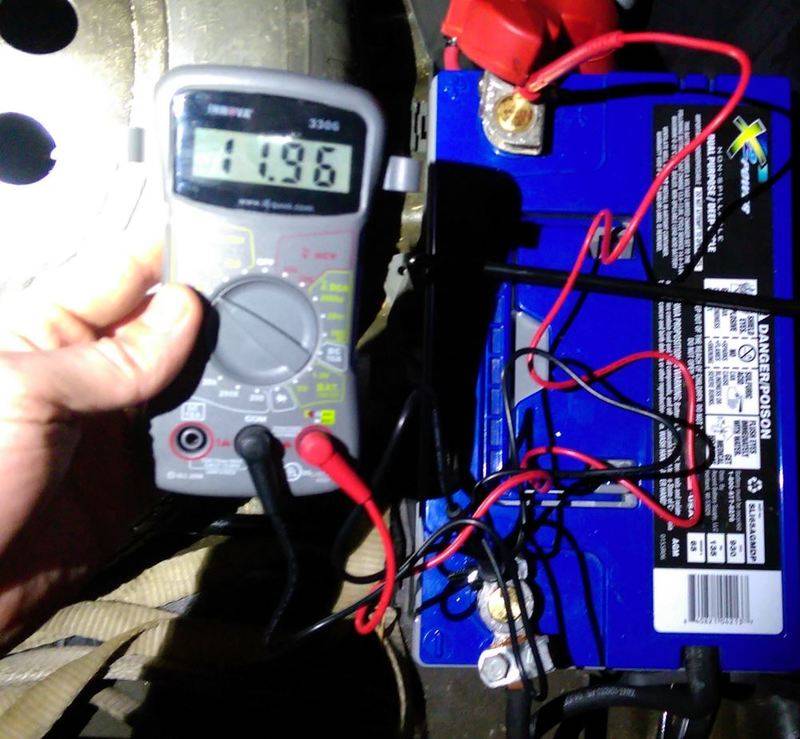

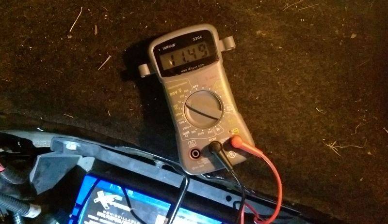

  • Left work at 6:00 and had to get a jump to start the car. Parked at home and took some more readings with the meter.
Car running:
Car engine off @6:14:
Car engine off @6:15:
Battery disconnected from car:
Based on the steady decreasing voltage while connected and the difference in voltage when disconnected I assume I have a heavy draw of power while the car is shut off. I understand I did not wait long enough for the car to "sleep" but didn't want to risk getting stranded again in the morning. Could that explain why it would not start with a fresh battery?
