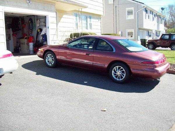

Hey thank you for responding to me. I do appreciate it. I am trying to figure out if I should buy this 95 and how bad it may break my piggy bank if it had problems. The guy wants 2000 for it. I was thinking about offering 1200. whats your thoughts?
With the pics you posted, it looks like it was taken care of. The headlights are not going to be bright enough. If you can, have the front end checked out, ball joints, strut bushings, tie rod ends, etc. It seems common the front end parts go bad around 100K miles. The wheels are not on properly, they should hook to the rear. They are directional wheels. $1200 would be a good price. If it's a Vegas car, chances no rust. Try and get any paperwork to see what has been done to the car.
