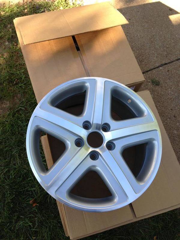

I have a set of the VW 19x9s I am trying to put on in the next month or so. These wheels will not be used year round, so take that in to consideration.
I need tires, and from what I have researched the best size to fit the wheel will be a 255/40-19 (an odd size)

I never noticed that yours look different than mine.
how so?
edit: I see yours are all silver with out the "polished" center section and lip. were yours replicas, or refinished?
how so?
Pretty sure they made them in both styles. I've seen pics of them both ways. I believe there are replicas you can find that are 18s too.
