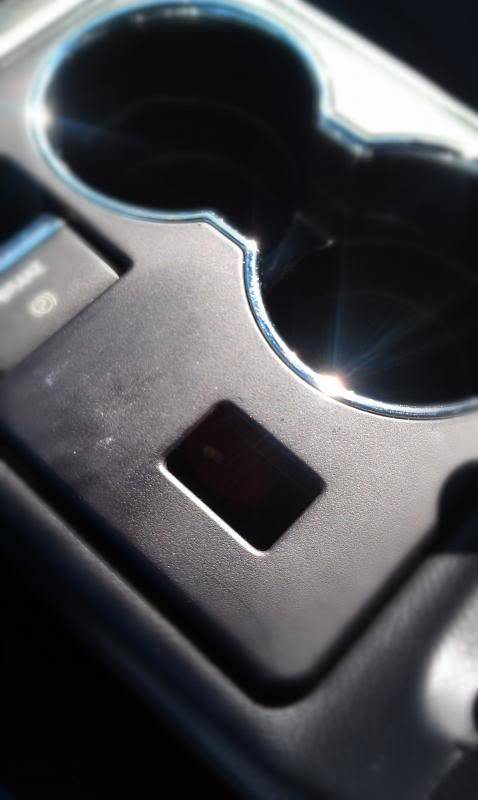

The traction control button was missing when I bought the car ~ six months ago... I finally decided to check it out and as you can see the plastic is busted where the two screws are. Think I can glue it back together? If so, any suggestions on what kind?

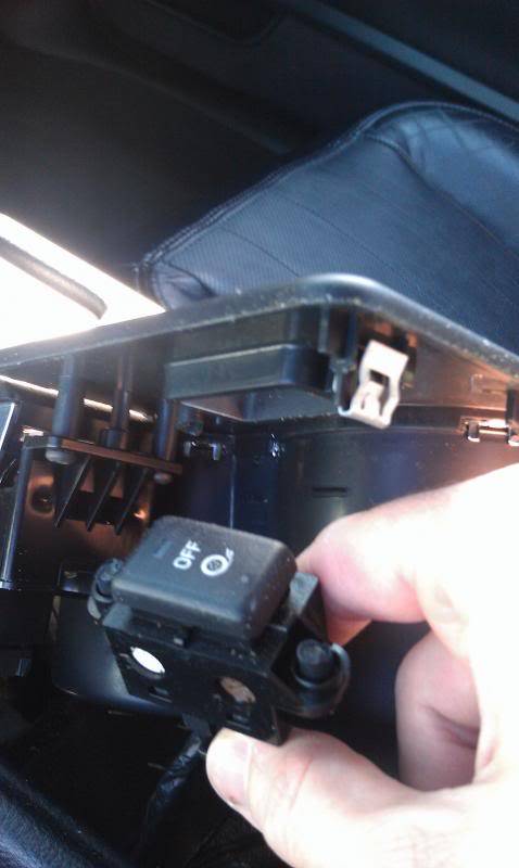

Yes, it can be fixed. I used JBWeld. The mounting posts are attached to the switch by the screws. Remove the screws and the posts will be loose. Money not being a concern I would purchase the new part. Check Tasca's web site (www.tascaparts.com) to see if the price is cheaper. If you do glue it be careful as there is a shoulder on top of the post that the switch slides into.
There is nothing that surrounds the switch. It sits in the opening.

The switch looks okay. The holder should be all you need.
If you get the new part, go ahead and reinforce it with epoxy at the mounts for the AdvanceTrac button and the e-brake button.

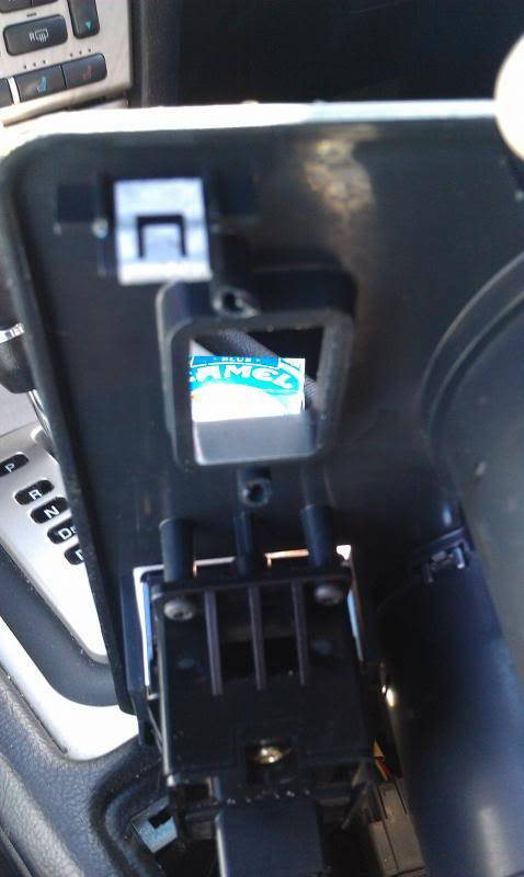

It's all you need. If you look at the bottom of the switch you can see the two posts still attached to the screws.

Yeah you're right. Just took out the screws and posts fell off. It'll be a heck of a lot easier to glue now ;) I might as well attempt to glue it while looking for a new one.
