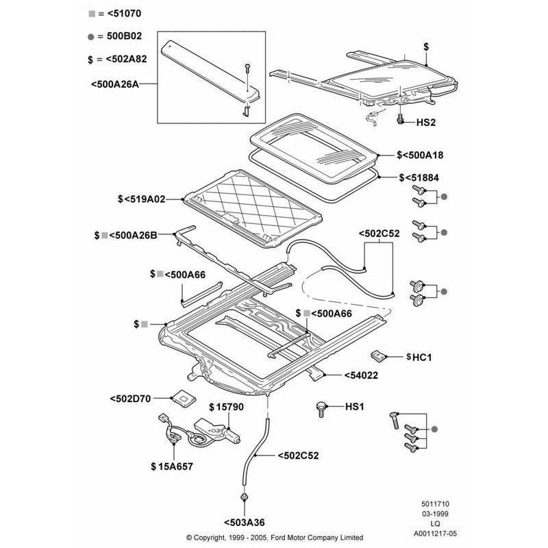

My wind deflector broke on my moonroof. I'm referring to the factory one that stores beneath the moonroof and pops up when you open the roof. The Ford part # is xw4z54500a26aa. Its 500A26B on the following diagram:

Hey what link , I assume its a link, are you using for these exploded views?
