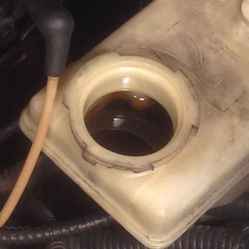

This was in my coolant tank.... any suggestions? I can def feel oil in the mix.

That's your brake fluid reservoir! Brake fluid normally feels a little oily. You haven't added anything to it have you?
The coolant reservoir cap is at the base of the windshield.

Hey joegr let me start off by just saying thank you for all your help. That is not the brake hydualic fluid tank, it is def my coolant tank at the top right of my engine right under the windshield. The plug you see is the device I un screwed to have better access to my plugs to be able to pull them out.
Look. No offense here, but maybe you don't need to be working on this if you can't tell that is the brake fluid reservoir. That is in front of the windshield on the driver's side on top of the master cylinder that is attached to the vacuum booster. The coolant reservoir (degas bottle) is right at the base of the windshield hidden behind all that stuff.

Ah , im sorry joe its been a long day, dealing with the boat and those 2 engines and a 2006 caddy with timing chain problems, your right that is my brake tank no worries the coolant tank looks all clear,
