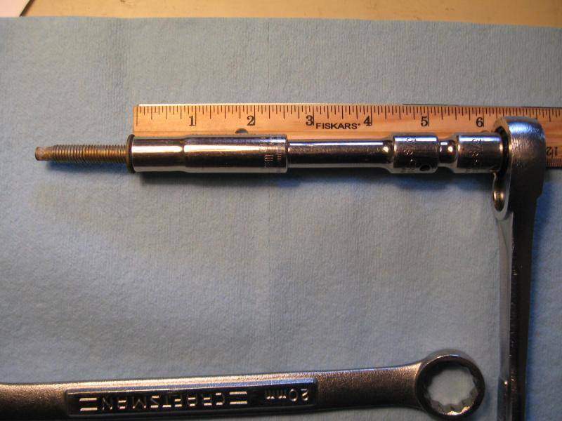

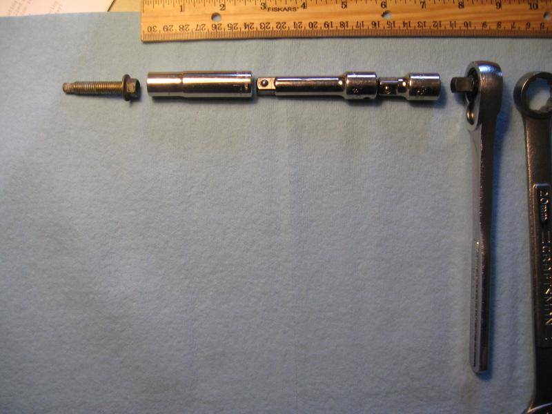

OK.. so I went back to my garage with a new attitude to never give-up and after several different attempts, I was able to resolve and pulled out that Starter 3rd bolt. This was How:
Assembled two- 3/8" extensions + 1- 10mm 6 side socket adding 6" in total lenght. I inserted the first 2 parts (socket + extension=5") with my bare fingers, once the socket was firmly engaged into the head of the Starter 10mm top bolt, then I added the 3/8" x 1" short extension, thus now I am at 6", then inserted the 3/8" Ratchet and pry hard to loosen up the Top Starter Bolt that was frozen, but by adding another wrench to the handle of the Ratchet, was able to use it as a lever and broke the bond and the Starter Bolt gave after producing a little "Boom" explosion when it went loose.
This made my day and make me a Happy Camper. See photos. IMG_4979.jpgIMG_4981.jpg
