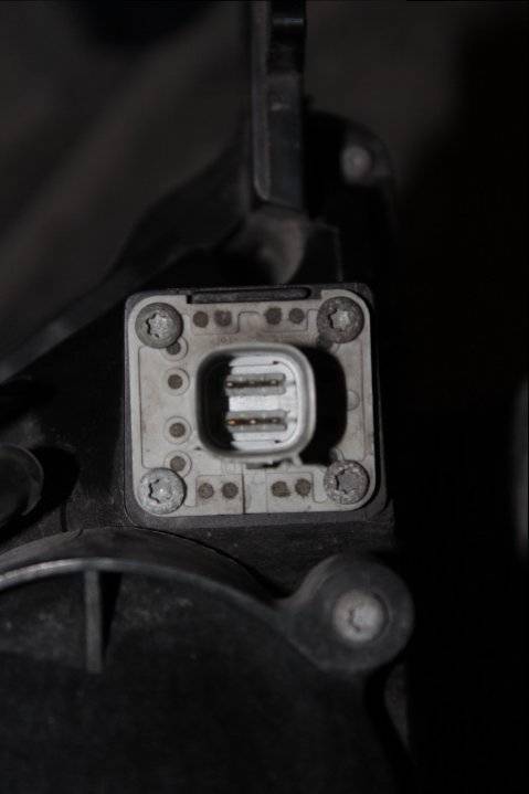

Hello fellow LVC members, I need some help. I'm trying to put install my OEM HID headlights that I bought off of Ebay on the car. Now the only thing is, I can't find the pigtails that plugs into the headlights anywhere. I currently have 03+ halogens on the car now. I was able to find the pigtails at Rockauto when I put these on. So I figured that they would work on the HIDs. Well wrong, they don't because there are two tabs on the male part that's on the light itself that slides into corresponding grooves on the pigtail. These don't match up. Can anyone with the OEM HIDs when you have a moment check and see if there is a piece of tape with a part number for that pigtail on your car? I would gladly appreciate it. Below is the piece that I'm referring to. These are the ones that I have currently on the car that matches the halogen headlights.
I think that most just grind the tabs off and use the existing harness.

Cable applied (female) connector to mate with your HID connector on the light is Molex p/n 33472-0607. And Molex p/n 33012-2001 can be used for the crimp terminal.
It is the MX150 series 6posn 2 row female connector with polarization B
Enjoy
