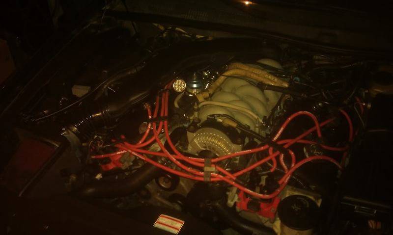

the car is a 95 with a bad engine, kooks, sct chip, under drives, 900 maf, cold air box, bbk fpr, and a few other things gears, Auburn locker, 255 walbro ect ect. it may have some cams. i got it to run and I could almost swear it was loping. (and well.... knocking) the p.o. was well... frustrated with it. he actually said "good riddance you fuggin b!tch" just before we left. i will get into that more as the build progresses.
picked it up for $650 solid car black on black base, no roof,no rust and 200k on car .

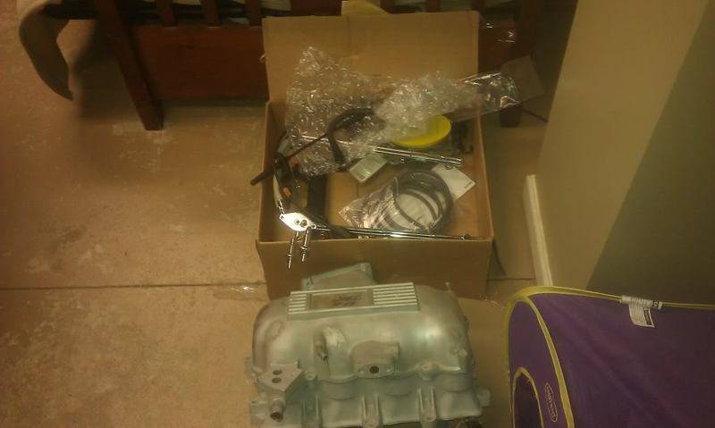

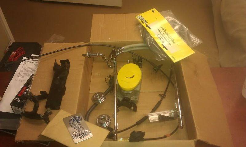

i have purchased a 96-98 cobra upper and lower with the rail, throttle cable, cruise cable, brackets for throttle + cruise cables, throttle body, 5/16 fuel line and some fuel line connectors.
the reason for the cobra intake, once i finish this part of the project, i want a vortec or procharger within the next year. then use the original block for a forged build and turn up the boost within the next year or 2.

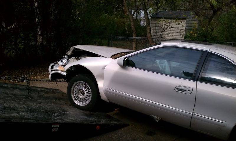

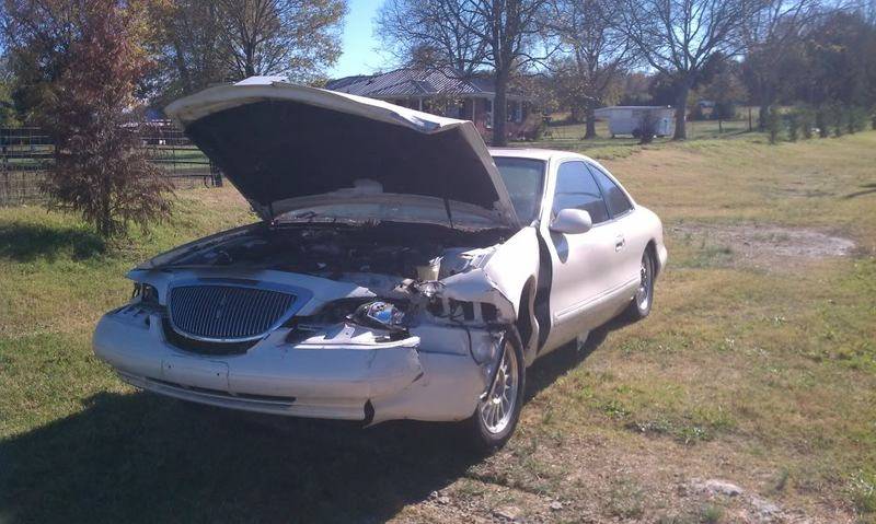

next week i am picking up a totaled 1998 mark with 80k, p.o. is keeping the trans :( but it will have the cop stuff and plastic imrcs and everything else under the hood
I am wanting to do a cobra intake conversion, cop conversion, egr delete, with a second gen motor in a 1st gen car, all at once.:eek:. now that is a rubix cube to me.:eek:
I know am in over my head, but i have been here before, things turned out ok last time. i have another mark to drive while i build this one. i want this stage of the build to be a 3 mo max project and i need help.

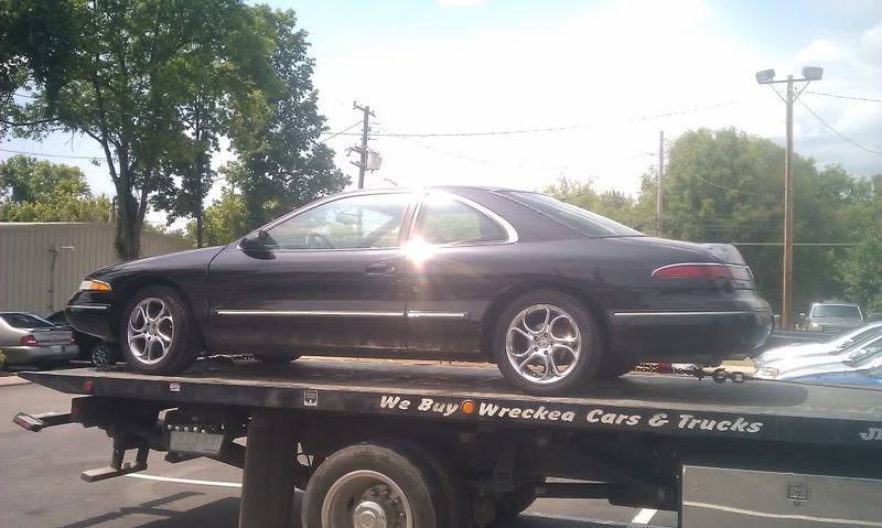

looks like there is going to be a 98 trans going in as well and the re pin for the swap. cadillacman let me have the trans with everything to do the jmod as well with the totaled out car. 80k actually on it. $400 for car minus interior and the front end is SMASHED!!!!
if anyone ever needs to know cadillacman is one solid dude!!!!!!

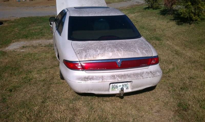

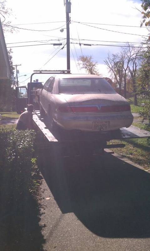

parts car finally home
pictures speak 1000 words. 65k on the white car and it came with a Ed Hall special on the back.
it is :q:q:q:qing on now...

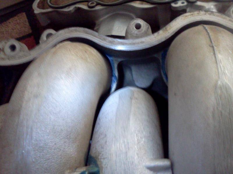

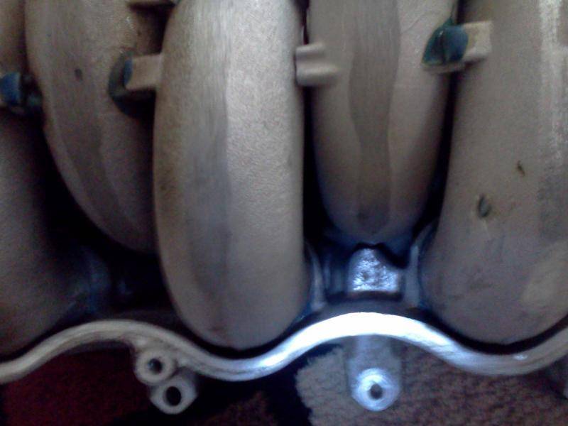

Before you put the Cobra intake on, if you are interested in doing some minor porting on the lower plenum, you can do so with a simple dremel. Shave back the casting around the runners.
Before:Cobra Lower.jpg
After: Cobra Lower 2.jpg
Sorry for the crappy picture quality.
If you do that around all of the runners on the lower plenum, it does seem to open it up quite a bit. I don't know if it helped or not, but I figured, more volume and less turbulence is better. :)
Before:View attachment 65625
After: View attachment 65624

Yeah, I wish the stock intake was that good on the Gen2s. :p
Anyhow, if you are going supercharged eventually I know some guys have done a "short-runner" intake setup with the Cobra intake which actually involves cutting the runners. Maybe ask around on here or do a little searching as I don't know the exact procedure for that. It is a little in-depth but will bump up your torque and horsepower curves. Another idea is deleting the IMRCs. Both of these things are two things I would definitely consider if you are going to go boosted.
