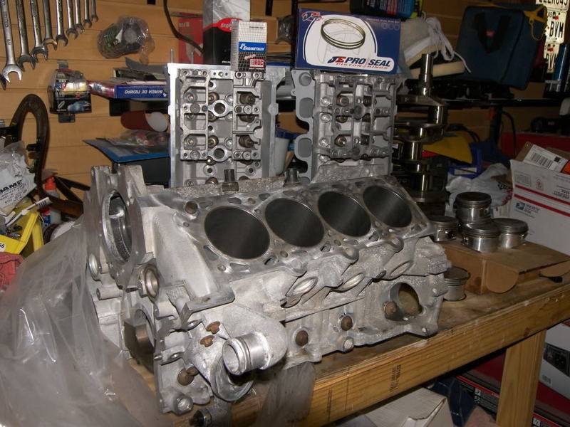

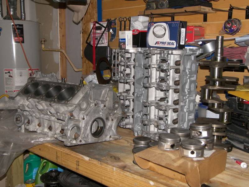

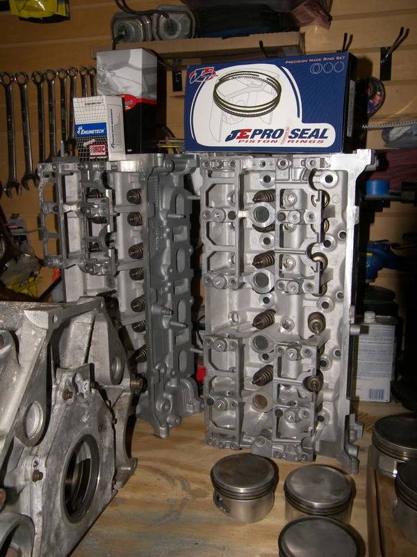

This process is going to take a bit, and I am not taking it lightly. My goals for this build is........Hell, I don't know what my goals are. I just want a potent engine with unlimited power potential. One thing I am not, is a weekend racer, so I am not to concerned there too much. My block heads and crank are already at the machine shop. The block check out good, The C heads only needed one exhaust cam, so I am good there. Today I got a heck of a deal on these.
I am now focusing on the pistons. The builder said the pistons checked out good, but I am thinking about a different piston. There are so many to choose from. Standard bore, .20 over. I welcome any and all recommendations. :)

I dropped two of the pistons off with the machine shop to use as reference during the boring. I decided to do a test fit with the rest. :p
