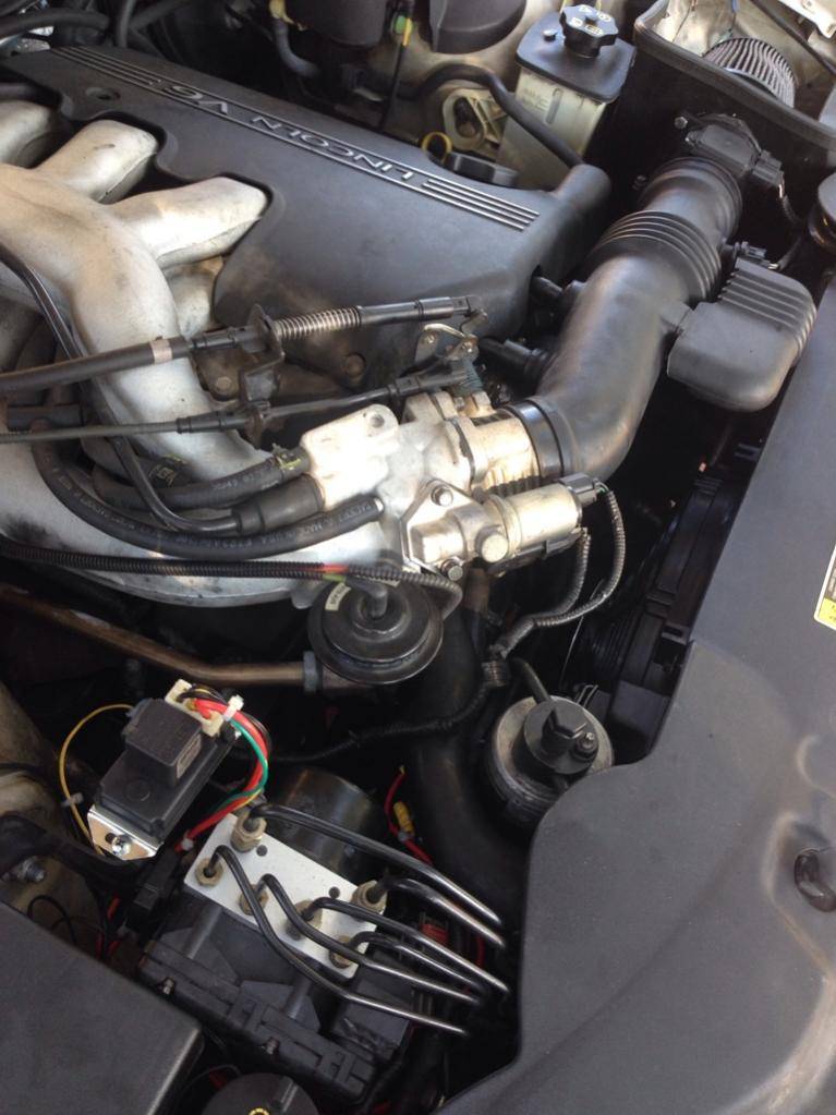

Ok guys I have a 2001 LS V6 automatic I just replaced the alternator and decided to take out the hydraulic cooling system because it was leaking everywhere fan,pump,hoses. And since I had the pulley from a Jaguar S type V6 I used it where the pump was located. So the problem is my car shuts off if the fan goes on any ideas guys?

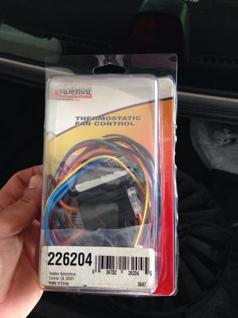

Fans are pretty easy to wire, I have done them in a couple of my own vehicles and two for other people. Although they tend to be easy to install, I have seen some installs messed up pretty bad.
Sometimes it is due to the fact that some kits are more involved to install and some instructions are less than clear, so what controller kit did you get exactly (brand/model)?

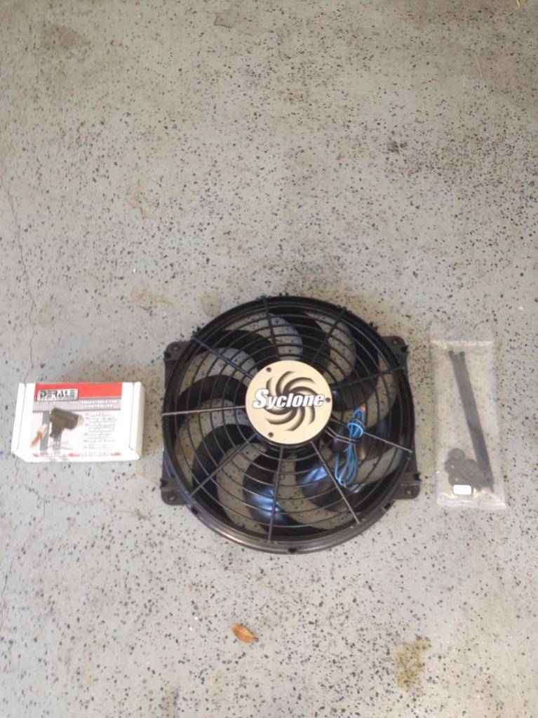

ImageUploadedByTapatalk1414803656.507256.jpg This is the kit that I bought and once the fan turn on the engine goes off
And I bought a 16" fan from the same brand name has the kit
That Jag fan takes a lot of current, too much to wire it to the underhood fuse box.

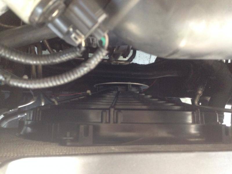

I'm thinking my mistake was hooking the power straight to the battery and the switch to the ignition key. I haven't seen no one done it like I did
ImageUploadedByTapatalk1416065849.957066.jpgImageUploadedByTapatalk1416065872.436670.jpgImageUploadedByTapatalk1416065948.176241.jpg
I finally fixed the Lincoln got myself a better fan and a better relay kit to make the fan work.. This time I power the fan thru the starter power cable and the switch thru the hydraulic pump switch cable and is working fine...
