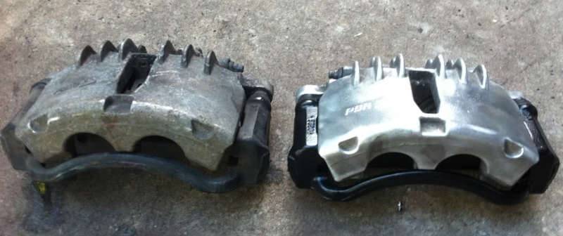

Picked these up at the junkyard today, was pretty pumped so snagged a rebuild kit from a buddy of mine and went to to work.
Rebuilt them, polished them up, and hit the brackets with hi temp black. No idea what I'm putting them on, but they will be on the shelf waiting for the next project.
Here's a before and after half way done...

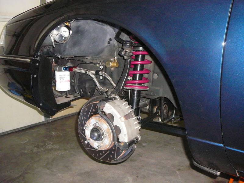

I have them on my car and have had no problems. They definitely have much better stopping power than the stock calipers.
Been using this setup for a year now...no complaints as of yet...but yes they are a tad smaller rotor vs the mark viii's brakes...but I don't test my brakes like that they work when I need them and that's all that matters...fwiw I plan on upgrading to cobra/Mach 1 calipers before I require new pads and rotors with the current Pbr setup...probably install Pbr setup on my '87 Tbird project
