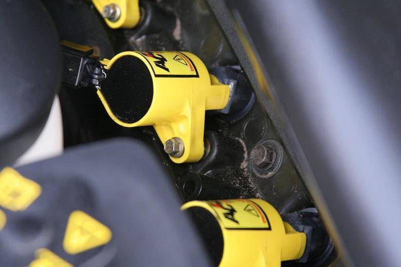

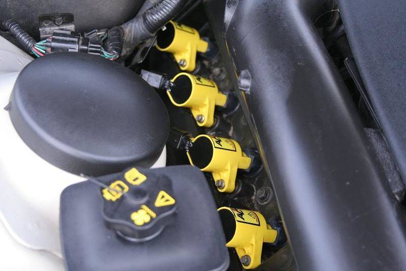

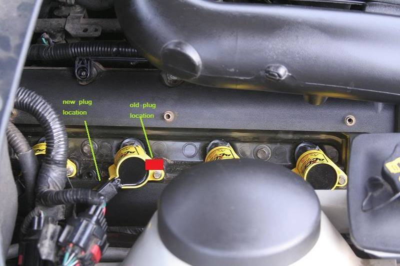

After a trip to 3 hardware stores, I found the longer bolts I thought would work. Nope. At least not with the washers I bought. So after fiddling with it, and a quick few text messages to Sully, here's what I did:
I just reused the stock bolts. The coils have a little play in them to get the holes to line up enough to get the bolt through. This holds a lot tighter than my original plan.
But, the possibility of doing different covers is now out of the question. The location of the plug on top of the coil is about 135 degrees counterclockwise from the stock location, making the wires stick out further than the stock cover would - cover.
Hey Pete did you re-use your old boots? I remember someone saying thats how it had to be but someone else said the angled ones worked and actually sealed better??????
Exactly. I tried swapping the boots for the stockers. And although it did make the fitting a little easier, it just left too much of a gap around the spark plug well for me to comfortably use them. The Accel boots seal the well much better.
