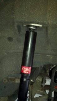

You can get the kyb gr2's for $23 dollars a piece
the same price as the monroes....im running them on my 97 and they are much stiffer then stock with 80,000 miles but not harsh. Cant beat the price of em. *shrug*
kyb part # 344110
