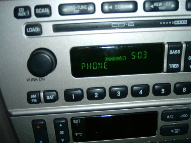

It's not too difficult. I added a Nokia to my 04. On the back of the radio are three connectors. There are several pins with no wires connected. One of these is the cell phone active signal. Ground it, and the radio switches to phone mode (display says phone, and radio comes on even if off or key was off). This is the pin to connect the cell phone "mute" output from the handfree kit into. Another pin (on a different connector, if I recall correctly), is the audio input to wire the speaker output of the handfree kit into. There is also a ground/return pin matching this audio input, but any ground should work okay. Most ford radios seem to have this feature, but the pins used move around from one model to the next. I wrote down the pin numbers to use somewhere, but I can't find it right now. I thought I had added the info to my wiring diagrams, but I didn't. You can look for the activate pin by touching a 100 ohm (to keep from damaging anything) resistor to ground and then to each of the unused pins, one by one. (This must be done while the radio is connected to the car.) When you hit the right one, the radio will say "PHONE." Then use another resistor to hunt for the two audio inputs. When you hit one, you will here some noise as you touch the pin.

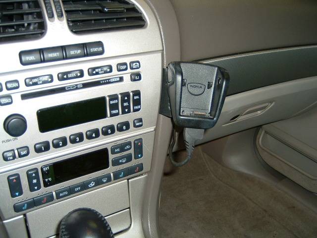

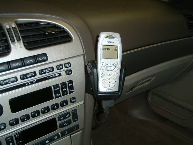

Go to the Nokia web site (www.nokiausa.com) and look up the handsfree car kit to use with your phone. I think that it is mostly one universal kit that they are selling now. Some of the phones use Bluetooth, and just have to be in the car. Others need a cradle to set the handset in. It is very handy. The cradle charges the phone and is easy in and out. [No cables to plug in and out each time, just a docking connector.] You won't need the speaker that comes with the kit (but you can use the cable attached to the speaker). You also don't need the extra handset option. Some phones connect to an external antenna through the cradle, but most just use the antenna in the phone. If your's has the external option, you'll need an antenna too. Anyway, find the part numbers you need at the Nokia site, then search the web for better prices else where. (You can order direct from Nokia, but they are more than most other places.) Lastly, you may want to go to www.pro-fit-intl.com to get a bracket to mount the cradle on. They make one for the LS that installs without altering the dash any. I can take a picture of mine if you would like.

Pictures of install...
http://www.lincolnvscadillac.com/attachment.php?attachmentid=12564&stc=1&d=1134949131
http://www.lincolnvscadillac.com/attachment.php?attachmentid=12565&stc=1&d=1134949131
http://www.lincolnvscadillac.com/attachment.php?attachmentid=12566&stc=1&d=1134949131
http://www.lincolnvscadillac.com/attachment.php?attachmentid=12567&stc=1&d=1134949131
