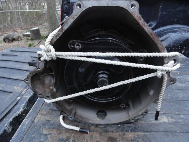

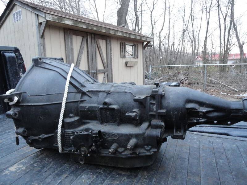

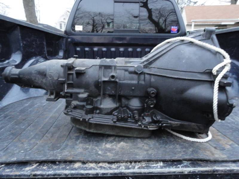

The first order of business was to pick up a new tranny. I got EXTREMELY lucky and got a custom built 4r70w from Performance Automatics for $400!!!
This transmission was used in a 99 Mustang project that was featured in MM & FF Magazine!!
Here's a link to the project article: http://www.musclemustangfastfords.c..._stealth_performance_mustang_4r70w/index.html
and here are some pics of the trans. in the bed of my truck:

According to the article, it's A 10-inch torque converter from Pat's Performance Converters with a stall-speed 0f 2,800 rpm. Does anyone know where I can find a cheap converter? i've been looking at a few, but my price range is low. I don't want to pay more for the converter than I payed for the transmission...lol.
What are your eventual power goals for the car? You're pretty much looking at finding a used convertor if your price range is that low, these little bastards are expensive.
Considered the options and decided to stick with the current 2800. I will not be racing in brackets or anything, just a weekend cruiser and such. I'll pair it up with a 1-piece and 3:73's and call it good for a few years. Once I get all that finished up, i'll consider upgrades in the future.
